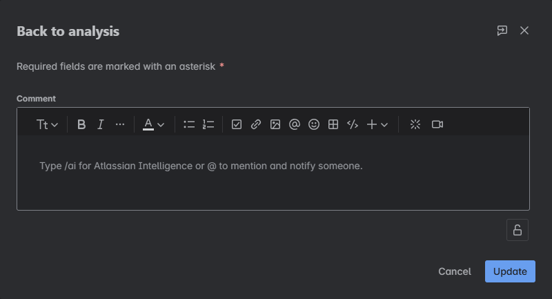

Can you maybe share a screenshot of what your 'comment' field looks like on transition? System Comment field uses wiki-style renderer which, combined with the new item transition experience, looks quite decent and you can use lists, text formatting, uploading files...
I believe even old experience offered these 'advanced' formatting options.
Is there, potentially, a custom field named "Comments" that uses text rendered, which would then reflect this behavior you're seeing?

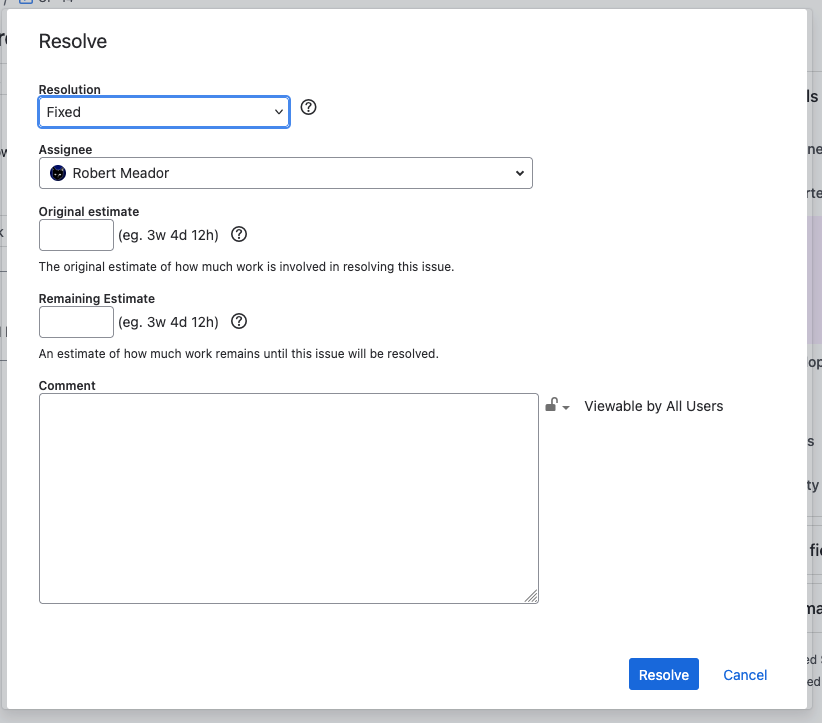

Sure thing. This is what I see when I transition a task to any other status that asks for a comment. You can see there is no WYSIWYG editor.

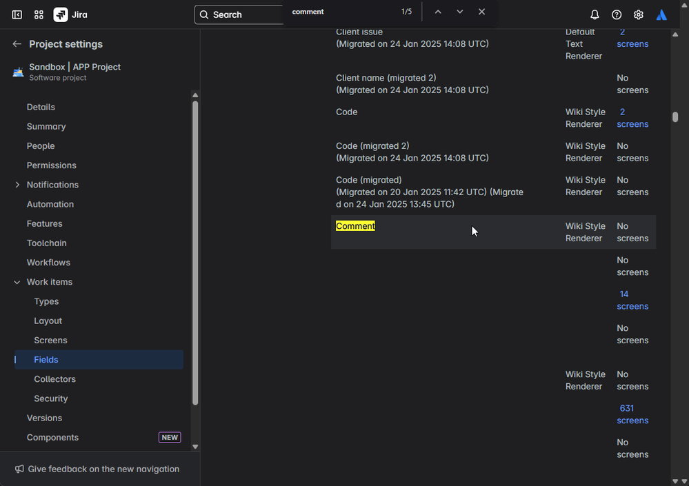

Can you check which renderer this field is using as part of the field configuration that your project is using?
So, navigate to Project settings > Work items (if you're using Jira/not JSM) > Fields and find "Comment". It should be set as "Wiki Style Renderer".
If it's not and if you're Jira admin, you could change it and you should be able to have WYSIWYG experience.

As stated in these docs, project settings 'moved' a bit, so try following that. If your interface doesn't look like the one visualized in the docs, please share a screenshot if you can.

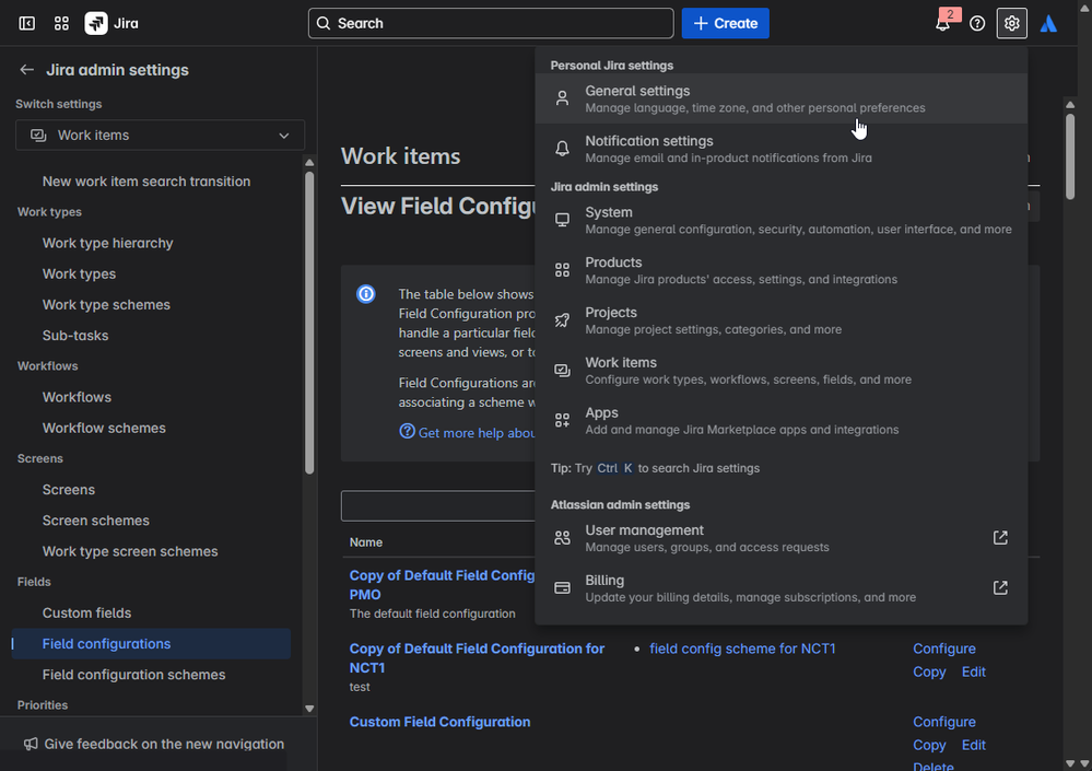

As for 'Personal settings', these also moved a bit — try clicking next to your avatar icon on Settings > General settings and scroll down to Jira labs.
Alright - found it. New transition experience enabled and I am seeing wysiwyg controls.
When I go to Project Settings > Work Items > Fields > Comments I see it's set to use the default text renderer, and I don't appear to have the ability to change it, at least not when editing an individual project (and I'd want to change it for all projects anyway). I see my example project is using the Default Field Configuration, so I suppose I'd want to edit that. But if I'm seeing wysiwyg now then perhaps there is no need.
