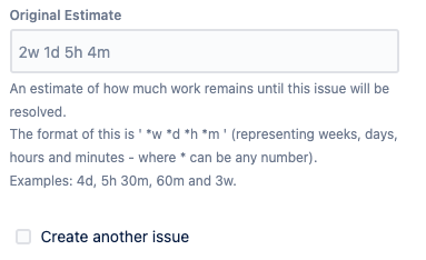

May 3, 2023
Not true, the original estimate can be on the create screen too, you just have to add the time tracking field to the create screen and you will see Original Estimate when creating the issue.

Mikael Sandberg
April 6, 2023
All you have to do is add Original estimate to your create screen. Just go to Project settings > Screens, select the screen used by the issue type you want to change and then add the field to the Create screen.

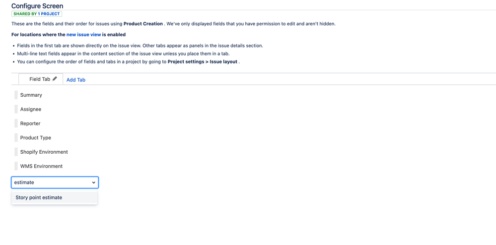

Batuhan Dogan
April 6, 2023
Do you mean add it from Field Tab? Because it's not popping up
Mikael Sandberg
April 6, 2023
My bad, you need to add Time tracking to the screen, that will add the original estimate field.

Batuhan Dogan
April 7, 2023
Thanks for the help Mikael, this issue has been resolved.
