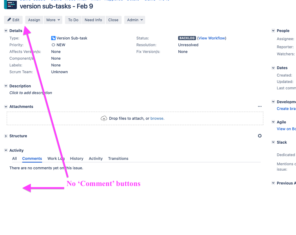

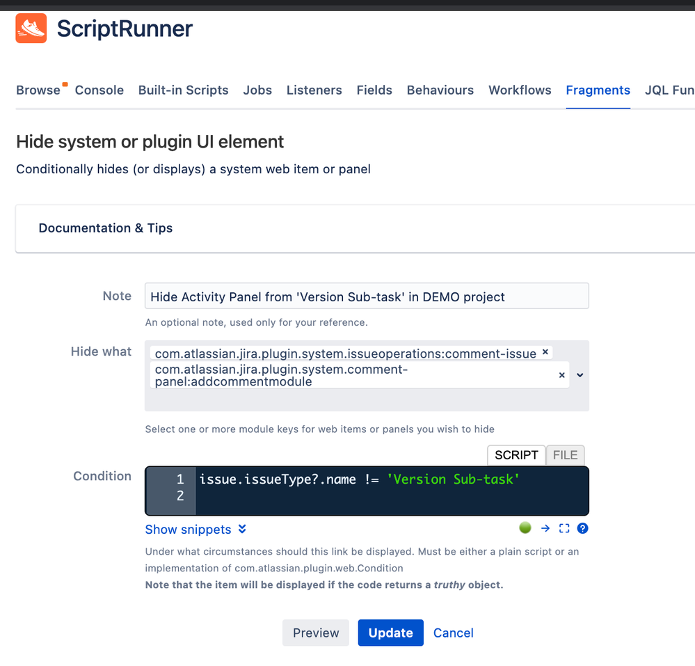

Yana Stoliarova
February 9, 2021
I used ScriptRunner Fragments (Hide)
