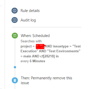

I want to delete executions that match specific criteria. I created the rule with the "Scheduled" trigger.

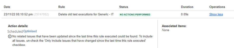

For now, I set the value "every 6 minutes", but actually it's planned to run the rule every day, not 6 minutes. This is just for a test. Anyway, the rule doesn't work. I tried to wait and check the results, and also run the rule manually, but the outcome is the same - executions aren't deleted. I cannot find what's wrong here. The audit log is also empty. Can someone advise how to fix it?

The problem is stated in the message in the audit log. "No related issues that have been updated since the last time this rule executed could be found."

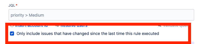

Look for a checkbox on the Trigger definition that says "only include issues that have changed". Make sure that is unchecked.

Yes, the checkbox was on. I unchecked and reran the rule.
He-he, it works, finally🤩
