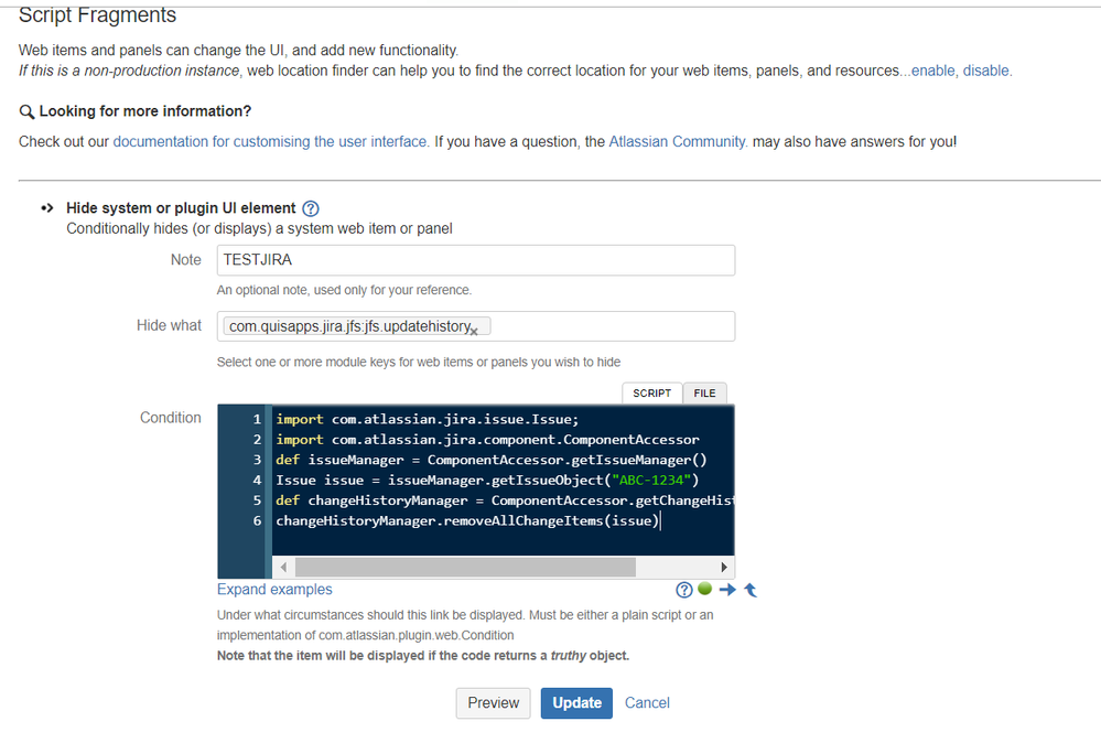

May 22, 2018
Hi  Young,
You can use these in the scriptrunner plugin. Install in JIRA and then go to script Fragment section of the plugin.
Select the update history class/method and put this code. This code will work for only one issue. You can try to make it generic. PFA screenshots.
import com.atlassian.jira.issue.Issue;
import com.atlassian.jira.component.ComponentAccessor
def issueManager = ComponentAccessor.getIssueManager()
Issue issue = issueManager.getIssueObject("ABC-1234")
def changeHistoryManager = ComponentAccessor.getChangeHistoryManager()
changeHistoryManager.removeAllChangeItems(issue)

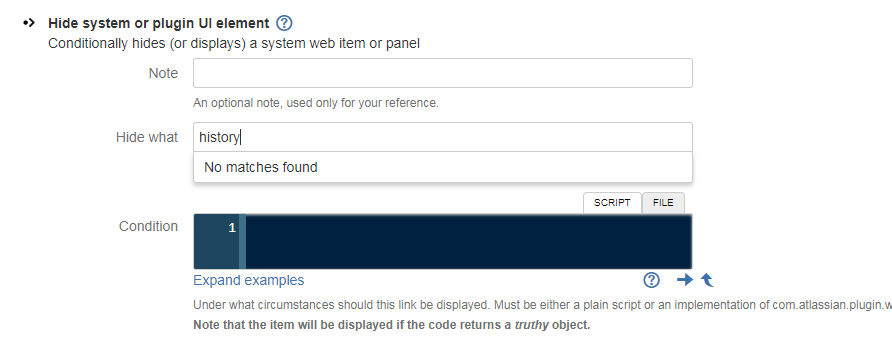

Young.Zhao
May 23, 2018
Hi Avinash,
Thanks for the prompt reply.
I tired as you told me, but I can't find "updatehistory" in "Hide What" field.
Could you advise that something I missed?
Thanks.
BR.
Young.Zhao
May 23, 2018
I know the reason.
I need to install "Field Security" add-on

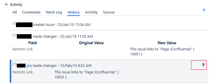

I found a plugin, it may useful to you.
"Issue history Item Remover"
Install this plugin in your find new apps.And you will get trash(bin symbol) on comments in history as shown below in red.
Cheers,
Fayaz
