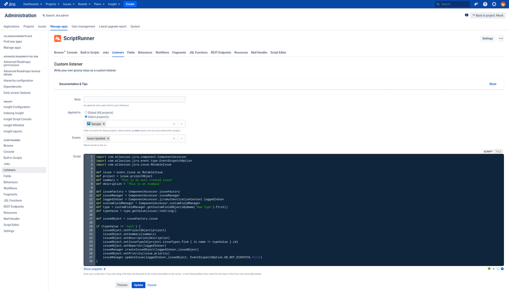

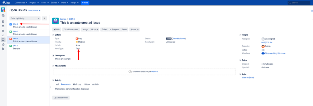

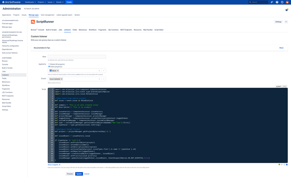

Below is a print screen of the Listener configuration:-
Below are a few test print screens:-

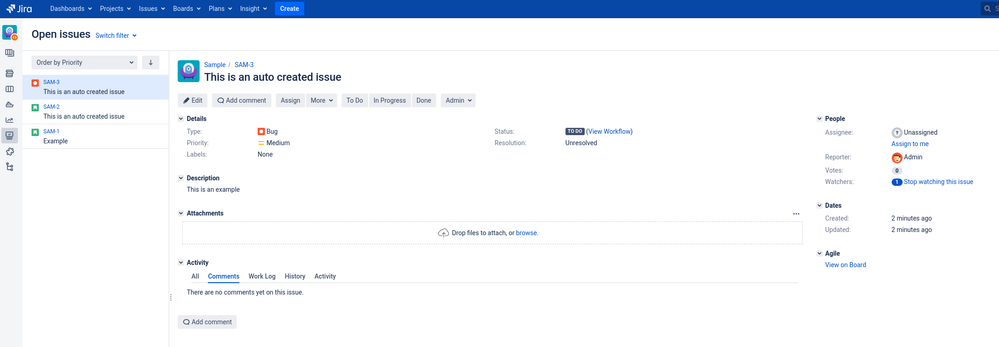

1) Sample existing tickets:-
2) Edit a newly created issue. By default, the New Type value will be None as shown in the image below:-

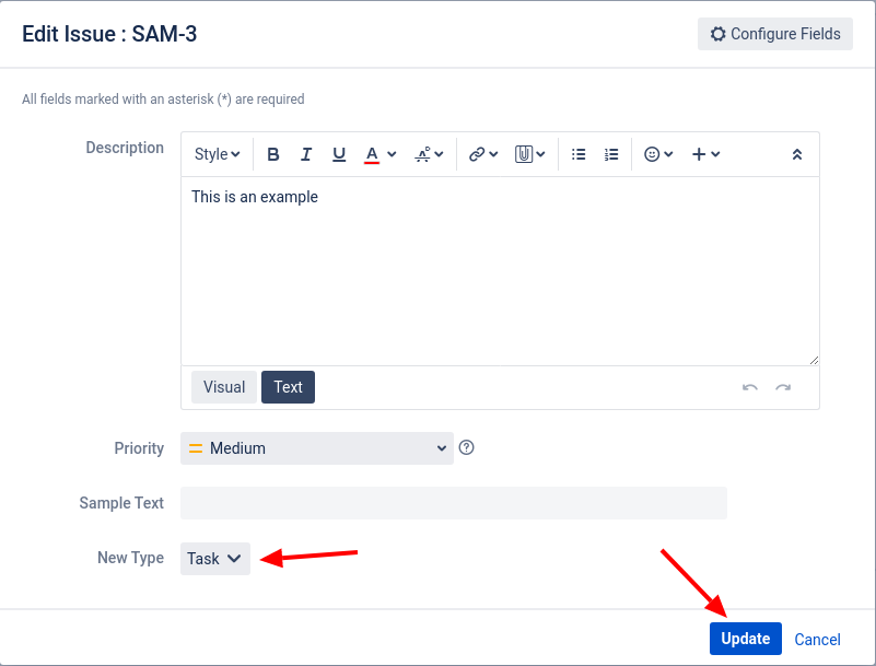

3) Update the New Type list to the issue type you want to create. In the example below, the issue type selected is Task. Once the New Type list is updated, click on the update button.

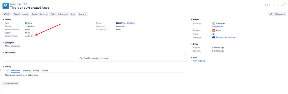

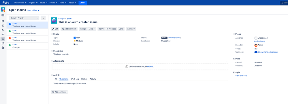

4) As expected, a new issue of Task type has been created.
5) Open the newly created issue. The issue will have the default Summary, and Description included. Similar to the original issue, i.e. by default, the New Type field will be blank. The field needs to be updated before it can be displayed.

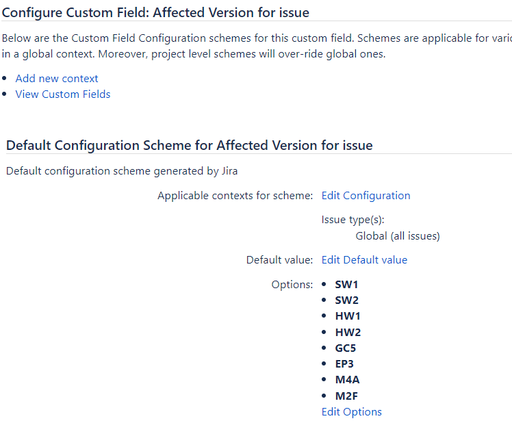

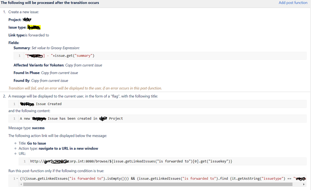

Thanks @Ram Kumar Aravindakshan _Adaptavist_  for giving me the solution. When I tried the above code with my requirements, I got an error. Screen shot is attached for reference.
And one more thing I did not mention in the above. Actually If I update the custom field "Affected Variants " in project called "ABC", the issue ticket should create in project called say "XYZ". If I want to create like this, what sort change should I do in the code?
And after creation of issue, is it possible to get some dialog box on screen with the information "New issue ticket created". ?

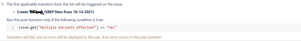

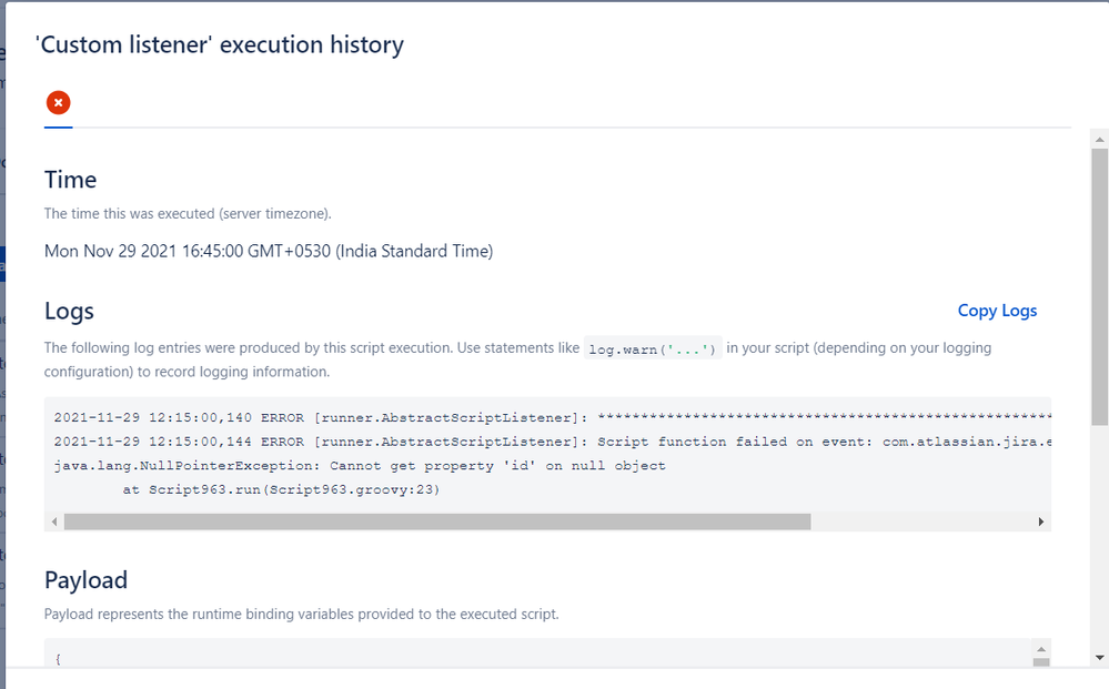

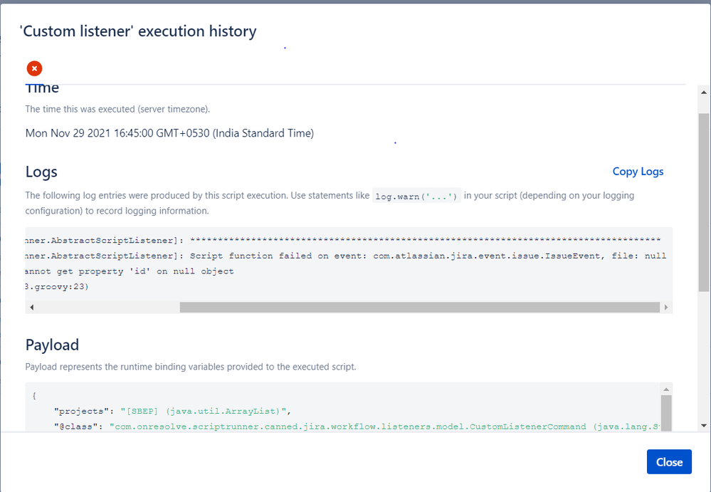

Sahish
December 8, 2021
Hello @Ram Kumar Aravindakshan _Adaptavist_
Today also I tested the listener.
I got the error which has shown below:
Logs:
2021-12-09 08:31:30,230 ERROR [runner.AbstractScriptListener]: *************************************************************************************
2021-12-09 08:31:30,230 ERROR [runner.AbstractScriptListener]: Script function failed on event: com.atlassian.jira.event.issue.IssueEvent, file: null
java.lang.NullPointerException: Cannot get property 'id' on null object
at Script1.run(Script1.groovy:23)
Payload
{ "projects": "[SSSS] (java.util.ArrayList)", "@class": "com.onresolve.scriptrunner.canned.jira.workflow.listeners.model.CustomListenerCommand (java.lang.String)", "issue": "SSSS-4458 (com.atlassian.jira.issue.IssueImpl)", "log": "org.apache.log4j.Logger@8a8a6be2", "friendlyEventNames": "Issue Updated (java.lang.String)", "version": "6 (java.lang.Integer)", "relatedProjects": "[[key:SSSS, name:SSSS]] (java.util.ArrayList)", "name": "Custom listener (java.lang.String)", "canned-script": "com.onresolve.scriptrunner.canned.jira.workflow.listeners.CustomListener (java.lang.String)", "id": "7992917c-b56e-4059-929a-d9cdc252f843 (java.lang.String)", "event": "com.atlassian.jira.event.issue.IssueEvent@ba9f55cc[issue=SSSS-4458,comment=<null>,worklog=<null>,changelog=[GenericEntity:ChangeGroup][issue,148866][author,JIRAUSER301][created,2021-12-09 08:31:30.183][id,1332500],eventTypeId=2,sendMail=true,params={eventsource=action, baseurl=http://abc.int.8095},subtasksUpdated=true,spanningOperation=Optional.empty]", "bundle": "com.atlassian.jira.event.issue.DefaultIssueEventBundle@4cf8a4b", "\u00a3beanContext": "com.onresolve.scriptrunner.beans.BeanFactoryBackedBeanContext@23042c2b", "events": "[2] (java.util.ArrayList)" }
Hope this data helps you.
December 9, 2021
Hi @Sahish
The issue is duplicated in the same project in the previous code I provided.
If you intend to create the issue in a different project, you will need to modify the code as shown below:-
import com.atlassian.jira.component.ComponentAccessor
import com.atlassian.jira.event.type.EventDispatchOption
import com.atlassian.jira.issue.MutableIssue
//Take issue from source project
def issue = event.issue as MutableIssue
def summary = 'This is an auto created issue'
def description = 'This is an example'
def issueFactory = ComponentAccessor.issueFactory
def issueManager = ComponentAccessor.issueManager
def projectManager = ComponentAccessor.projectManager
def loggedInUser = ComponentAccessor.jiraAuthenticationContext.loggedInUser
def customFieldManager = ComponentAccessor.customFieldManager
def type = customFieldManager.getCustomFieldObjectsByName('New Type').first()
def typeValue = type.getValue(issue).toString()
//Configure Target Project
def project = projectManager.getProjectByCurrentKey('RL')
def issueObject = issueFactory.issue
if (typeValue != 'null') {
issueObject.setProjectObject(project)
issueObject.setSummary(summary)
issueObject.setDescription(description)
issueObject.setIssueTypeId(project.issueTypes.find { it.name == typeValue }.id)
issueObject.setReporter(loggedInUser)
issueManager.createIssueObject(loggedInUser, issueObject)
issueObject.setPriority(issue.priority)
issueManager.updateIssue(loggedInUser,issueObject, EventDispatchOption.DO_NOT_DISPATCH,false)
Please note, this sample working code is not 100% exact to your environment. Hence, you will need to make the required modifications.
In the updated code, when the change is made to the New Type list in the MOCK project, the new issue will be created in the Restrict Links (RL) project.
However, the Listener is configured for only the MOCK project, i.e., only when the New Type list field is updated in the MOCK project will trigger and create a new issue in the RL project and not vice-versa.
Below is the updated listener config:-
If you intend to trigger it from either project, you will need to modify the Listener configuration accordingly.
I hope this helps to answer your question. :)

Sahish
December 10, 2021
Affected Version for issue is one custom field with Select list having the above options for selecting.
Hope this data help you
Thanks,
Sahish

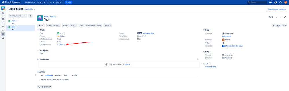

1) When the Sample Version picker field is updated in the MOCK project, as shown below, a new issue is created in the RL project as shown in the 2nd print screen.
2) The RL Project creates a new issue and updates the Sample Value picker matching the values set in the MOCK Project.
I hope this helps to solve your question. :)

When I run the code, again it didn't get execute. The logs are as follows:
2021-12-14 12:55:29,301 ERROR [runner.AbstractScriptListener]: *************************************************************************************
2021-12-14 12:55:29,314 ERROR [runner.AbstractScriptListener]: Script function failed on event: com.atlassian.jira.event.issue.IssueEvent, file: null
com.atlassian.jira.exception.CreateException: Error occurred while creating issue through workflow:
at com.atlassian.jira.issue.managers.DefaultIssueManager.createIssue(DefaultIssueManager.java:519)
at com.atlassian.jira.issue.managers.DefaultIssueManager.createIssueObject(DefaultIssueManager.java:616)
at com.atlassian.jira.issue.managers.RequestCachingIssueManager.createIssueObject(RequestCachingIssueManager.java:212)
at com.atlassian.jira.issue.IssueManager$createIssueObject$1.call(Unknown Source)
at Script9.run(Script9.groovy:31)
Caused by: [InvalidInputException: [Error map: [{customfield_15260=Please select the mandatory fields, components=Please select the mandatory fields, priority=Please select the mandatory fields}]] [Error list: [[]]]
at com.googlecode.jsu.util.ValidatorErrorsBuilder.process(ValidatorErrorsBuilder.java:49)
at com.innovalog.jmwe.plugins.validators.GenericValidator.validate(GenericValidator.java:133)
at com.atlassian.jira.workflow.SkippableValidator.validate(SkippableValidator.java:45)
at com.opensymphony.workflow.AbstractWorkflow.verifyInputs(AbstractWorkflow.java:1466)
at com.opensymphony.workflow.AbstractWorkflow.transitionWorkflow(AbstractWorkflow.java:1167)
at com.opensymphony.workflow.AbstractWorkflow.initialize(AbstractWorkflow.java:606)
at com.atlassian.jira.workflow.OSWorkflowManager.createIssue(OSWorkflowManager.java:754)
at com.atlassian.jira.issue.managers.DefaultIssueManager.createIssue(DefaultIssueManager.java:513)
... 4 more
Could you please help me on this.

Sahish
April 19, 2022
Hi @Ram Kumar Aravindakshan _Adaptavist_ ,
We already have two post functions in the workflow for creating one new issue in two different transitions:
This post function in "Implement" transition.
This post function in "Create new issue" transition.
So, Whenever I am changing the status from Analysis to Implement, I will get one popup screen which has Multiple Variants and Affected Variants (dropdown) Custom fields. If I select Affected variants are some abc, efg , so immediately separate two new issue tickets will be created for these affected variants (used post functions to create a ticket over here) and the issue will be in Implementation status.
So now during this status, I found that other affected variants Like klm, xyz also affecting. I updated the ticket with these variants from the edit option on the screen. So now the total variants are abc,efg,klm,xyz. Now I need to get another separate two new issue tickets for the affected variants klm and xyz. This is my requirement.
Is it possible ? Please advice.
