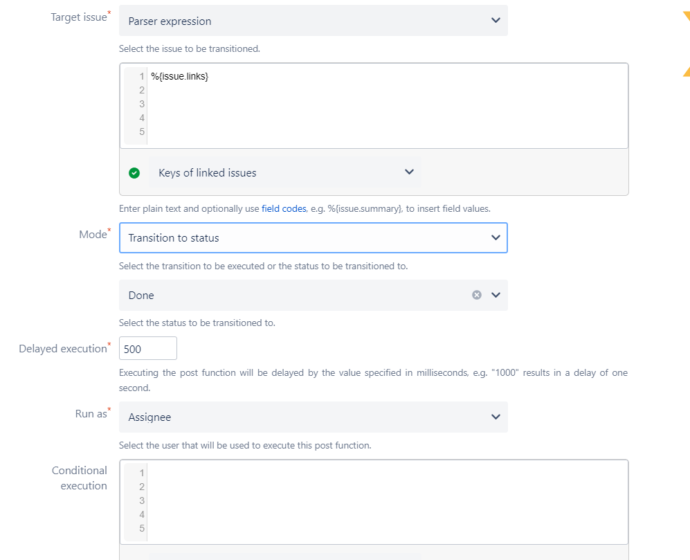

Hi,
My scenario is when user story is closed, all the linked issues (task, defect) should also be closed automatically.
I have tried using JWT plugin, i have inserted postfunction, but that post function is working when only one linked issue is there, if there are more linked issues (eg 2 to 3 defects). its working.
Could any one please respond & resolve it.

Ansar Rezaei
January 5, 2020
Hi
Could you give me the name of the post function related to this picture? I could not find any in the JWT plugin similar to this.
seethamraju
January 5, 2020
Hi @Ansar Rezaei
Name of the post function is transition issue by JWT.
Thanks,
Raju
Ansar Rezaei
January 6, 2020
Aha! I'm working on JIRA Server. I check out cloud documentation and see you configure it correctly.
Please check for:
1- Done Status is available in the workflow for all linked issues
2- There is a transition to the Done status of the current status of all issues
3- All conditions/Validators on the transition to Done for all linked issues could be satisfied when you close the story.
seethamraju
January 6, 2020
Hi @Ansar Rezaei
Please refer above comments from @Julian Riedinger _Decadis AG_ . Seems that feature is not available in JWT. they were trying to implement this scenario.
Thanks,
Raju
