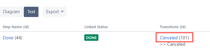

I suppose you have found the answer, as this thread is more than 3 years old. Anyway for others (like me): you may find the transition ID in the workflow configuration, text mode.
