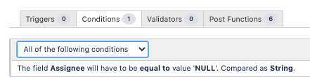

At the top of the Conditions tab is a pull down field that lets you designate how the Conditions will be evaluated. The choices are:
All of the following Conditions
Any of the following Conditions
If "All" is selected, then all the conditions must be true for the transition to be blocked.
If "Any" is selected, then if any one of the conditions is true, the transition will be blocked.
You can also use the Grouping feature to group conditions and change the All/Any applied to each group to make more complex scenarios.

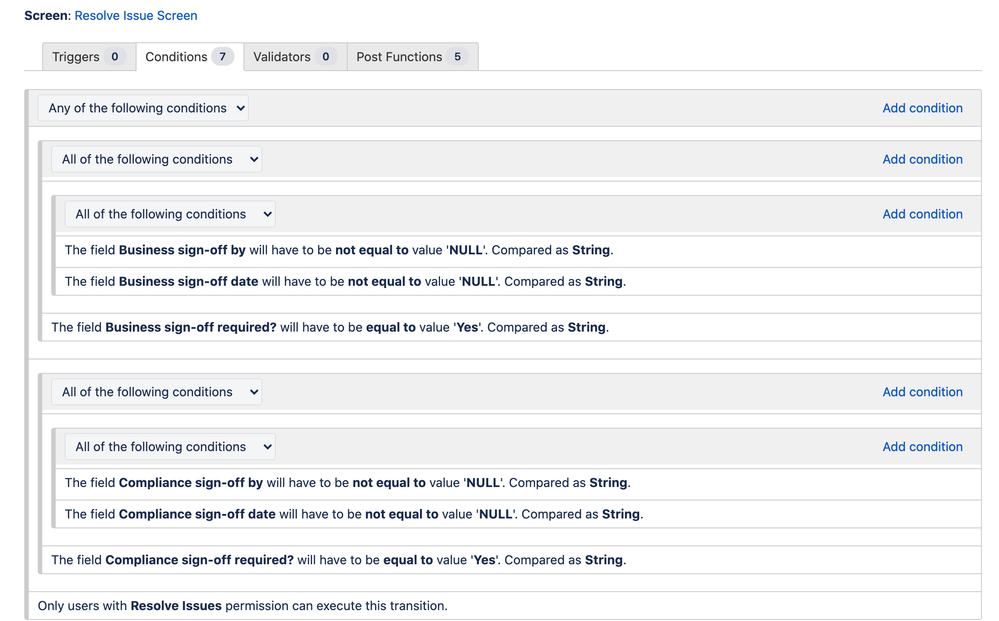

Hi, please can I have some more assistance as this hasn't worked how I needed.  I have tried both the 'All' and 'Any' mentioned above.
If I choose 'All' then the tickets which are marked as 'No' to the compliance and business sign off are being blocked from transitioning to 'Resolved'.
If I choose 'Any' then where the 'Compliance sign-off required' and 'Business sign-off required' is marked as 'Yes' but the name is only populated against 1 of the fields, then the ticket is still transitioning to 'Resolved' when it should be blocked from doing so.
Here's how I have it set up:
John Funk
October 1, 2020
Hey Kara,
I think you have it right except for the Only users with Resolve Issues permission can execute this transition. Since it is a part of the Any, the anyone with that permission can execute regardless of the other conditions.
So to solve that I would either move the Resolve Issues to a validator instead of a Condition or add it to both of the other sections next to the Required? = Yes fields.
Finally, if a user can move the card if neither of the Required? fields = Yes, then you need a way to handle that. Because right now, cards with No for both of those fields will not be able to move. If you DO need that, then it would got down where the Resolve Issues permission line is (at the very bottom).
Try those changes and see how it goes.

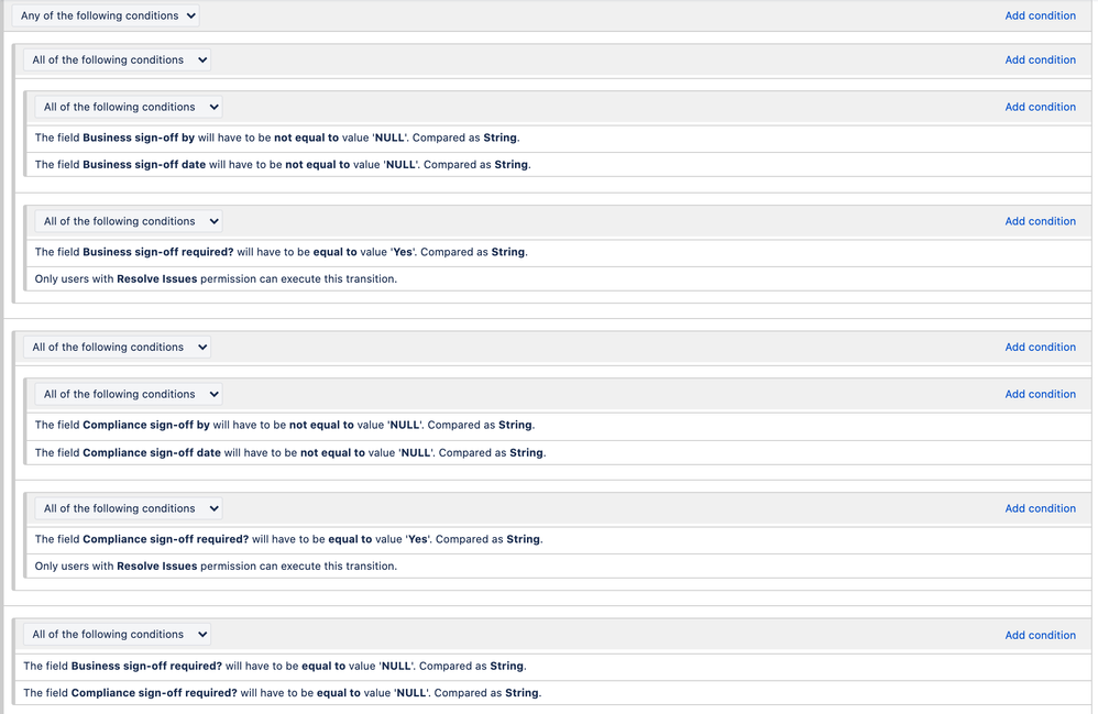

Thanks, sorry for the late reply. I still cannot work this out.
If I set the very top condition (on the screenshot)  to be 'Any' then I can set e.g. Business sign-off required as 'Yes', enter the associated name and date and I am able to resolve the ticket (as expected, if I don't enter the name and date then I am unable to resolve).
However if I also set e.g. Compliance sign-off required as 'Yes' but do not enter the required name and date, I can still resolve the ticket.
If I set the top condition to be 'All' then it doesn't work either.
I am obviously doing something wrong, but I just can't seem to work out what it is!
John Funk
November 6, 2020

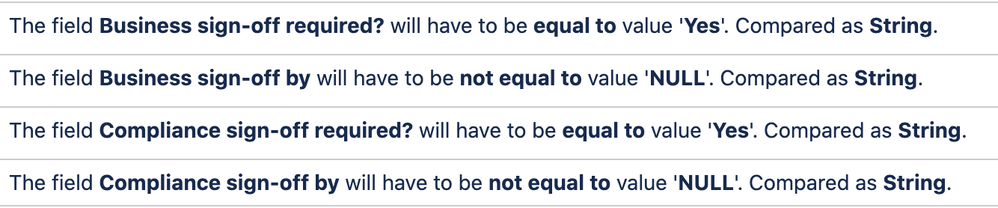

Hey Kara - without jumping into this too much, what if you did the following:
In the first condition text above, change "not equal" to "equal" and change "NULL" to "Yes"
Get rid of the 3rd condition and move the 4th condition up to the same level with conditions 1 and 2
In the 5th condition - do the same as you did in the first condition above.
Same thing for the 7th and 8th conditions based on the 3rd and 4th conditions above.
Finally, I would change the last two conditions to be equal to No
And I would require a value for the field so that Null is not an option.
Give that a try and see what you get. You are very close though, I think.
