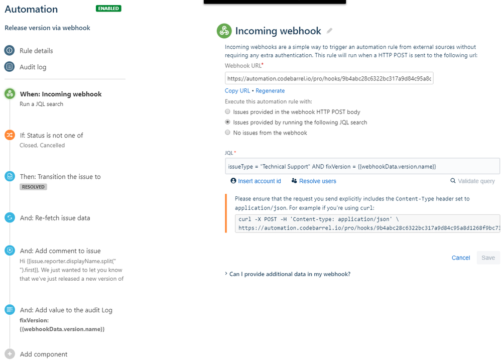

Gil
October 9, 2019
Ok, I found it!
So with one simple rule, I'm able to transition JSD issues to RESOLVED with resolution FIXED when a bug/task/story is linked to a JSD issue.
  • Create a rule in JSD with When: Incoming Webhook trigger and COPY the URL.
  • In Jira System settings > Webhooks, generate a new webhook and name it Version Released
  • Under Project related events, tick released.
  • In the URL on that same screen, I also pass ${version.name} just to be safe it works.
  • Save your Jira webhook
  • Back in your AJ rule, you need to execute this automation rule with: Issues provided by running the following JQL search
  • The JQL in my case is:
issueType = "Technical Support" AND fixVersion = {{webhookData.version.name}}
  •  Then a simple IF status condition
  • Transition issue to Resolved. In my case, I have my Jira workflow that when a JSD issue is in status = "internally resolved" and it transitions to "resolved", to set the resolution field to FIXED (because I assume it requires a code change)
  • I re-fetch the issue to get the updated status of my JSD issue and then add public comment for the customer.
The only manual work for me is to click the 'Release' button in Jira. In the future will hook it with Gitlab and it will be fully automatic.
:D
Victor Seger
October 10, 2019
Hi Gil,
Thank you very much for sharing your solution! I’m glad it worked fine!
Just as a suggestion, you don’t need to use the “re-fetch issue data”, since it updates the information inside the rule, instead of acting directly on your issue. So, to your use case, it will not have a practical effect and not using it can give you process advantages :)
In case you have any other question about this, please feel free to reach us again.
Cheers,
Victor

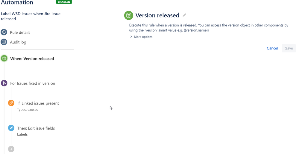

October 8, 2019
Hi @Victor Seger and @Stanisław Juźwicki
Thanks for your detailed reply.
I did the 1st part as suggested. can you please confirm if this is what you meant:
I currently set the label value to: version-released.
Is it possible to have a smart value in labels? example: version-released-{{version.name}}
I set this rule as a GLOBAL rule.
The 2nd rule will be created in the JSD project.
is this ok?
Stanisław Juźwicki
October 8, 2019
Hi Gil,
Not sure about smart values in labels, think it should work, but I hope Victor can confirm.
Your first rule looks ok.
As for the second - if I understood your requirement right, the second rule should also be global (or set to the core projects when you have your issues that are released), not set in JSD. This is because the trigger (adding labels) happens in the Jira core project, not in the JSD project. So the rule will have a trigger in a core project and the actions in JSD.
Edit: hmmm… I am just wondering whether you really need that condition "if linked issues present" in the first rule. I would think about "labeling" all the issues released in a version, also if they were not caused by a JSD issue - but that is another discussion I guess, not connected with this requirement. Even if you do not have that filter in your first rule, the second rule will only iterate over the links, so it anyway won't work on issues that don't have links.
Gil
October 8, 2019
Hi Stanislaw,
Let's review my rule.
  1. It's a global rule because any Jira project that has versions released, can be linked to my single JSD project. Furthermore, I need to look at issues that are released in Jira projects and then edit my issues in the JSD project. Therefore, I must have this rule "sitting" above all Jira/JSD projects.
  2. When a version is released in any Jira project.
  3. Branch for issues that are fixed in this version
  4. Do these issues have linked issues with 'Causes' type? If yes, then
  5. Edit the JSD issue with a label.
So for #4 - I didn't know what to select, and "Are present" seemed appropriate because it's checking that the branch rule has released issues in this version with linked issues in JSD project.
Or, did I get it completely wrong?
