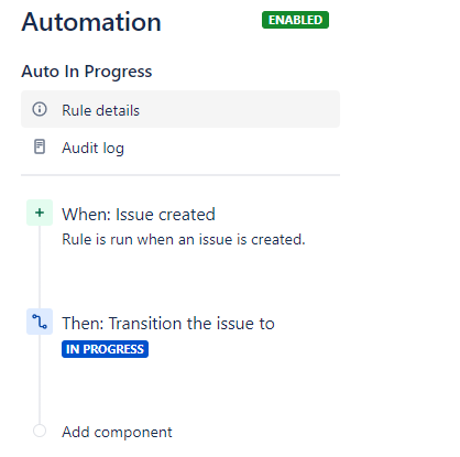

Jonas Ekström
July 20, 2021
Sorry, apparently not fully awake and missed the part where you mentioned doing it in the same rule. In my mind it just appeared as two different rules..
Not sure if it's possible to it in the same rule, doing it in two separate rules is easy though
In addition to this, the rule needs to be able to trigger of other rules. Also you certainly would like to add a condition, "if" for a specific query to just identify these automatic creations

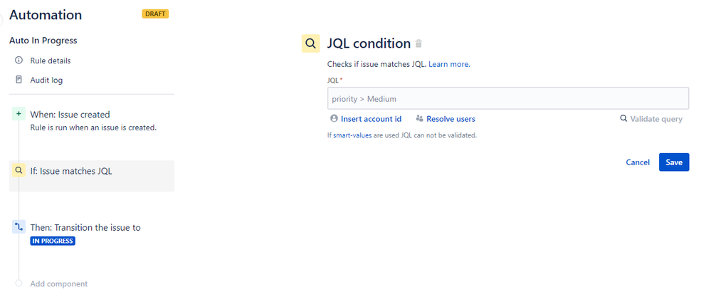

Jonas Ekström
July 20, 2021
You need to add a condition component in between, for example JQL condition.
When you create your issue in the first rule, you need to create it with a unique method of identification. Either if you decide to set a label, or a specific summary that won't be used by other issues.
Tak S.
July 20, 2021
Thank you for your advice.
At last I successfully created automatic transition rule!
Maybe it would be better to create state transition rule as child component of the condition component, not as a next component of it?
Anyway, thank you very much for your quick and helpful advices!
