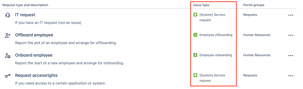

Yes this is possible but it is related to an issue type rather than a Request Type.
Your Request Types are related to an Issue Type.
In the example above you can see that both IT request and Request accesrights have the same Issue Type. Changing the workflow (which will be explained a little further) for the issue type [System] Service request will affect both Request Types. If you don't want that to happen you need to setup a new Issue Type but maybe the one you want to change already has its own Request Type or it's ok if all of the related Request Types change.

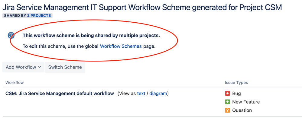

Now you need to update the Workflow Scheme of that project. Go to your JSM project and click Project Settings. Click on Summary in the left hand side and select Workflows. If you have a JSM project that shares configuration with other projects you cannot add the just created workflow. You would see the following:

If it's not shared you don't see that and you can add the created workflow. Please note that having separate Workflow Schemes is a cleaner solution. You can read more about it here:

Now if it's a shared workflow please be warned if you add a workflow to change the workflow related to an Issue Type (that is related to your request type) that will trickle down to all related projects. Creating an unwanted effect. In that case please refer to the link from Atlassian above to create a separate Workflow Scheme that you can apply to your JSM project.

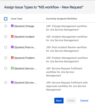

If it's not shared or you created a neat new Workflow scheme and added it to your project you can add your workflow. Click on Add Workflow followed by Add Existing. Search your earlier created workflow in the earlier step, select it and click on next. Here comes the tricky part (or not so tricky if you understand it). You will see this screen:
As said before you need to know which Issue Type is related to the Request Type you wish to add a new workflow for. Select that specific issue type here and click Finish. If you did it right you will see a couple of issue types having one workflow and your selected issue type having your new workflow. You will be asked to Publish your new workflow. Click on Publish.
