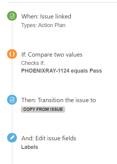

P.S.: I thought about creating automation rules, but the status options "To Do", "Pass", or "Fail" are not available. I would greatly appreciate any help.

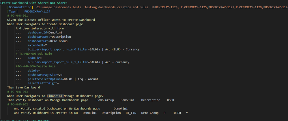

Sorry, I just saw your message. I’ll try to explain the problem more clearly. In the screenshot, you can see what my test looks like. This test consists of three test cases. These three test cases are present in Xray.
I set it up this way to reduce duplicate tests and save time. The actual issue is with transferring the results. When I want to automatically transfer the result to Xray, it only takes the test that is recorded on the day.

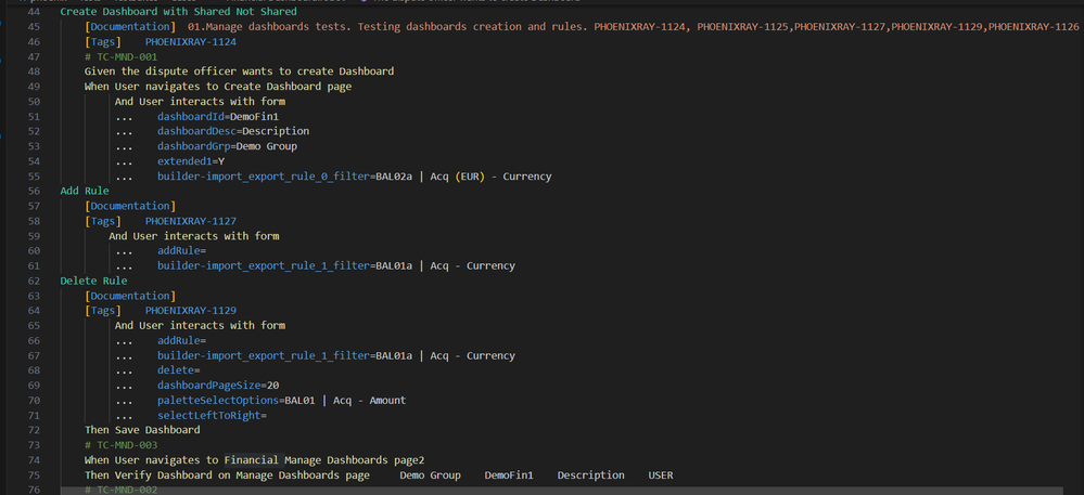

See the second screenshot. I tried to fix the issue. It worked for this single test case, but when I run multiple test cases together, only the first test case works, and the rest fail because the application isn’t closed and then times out.

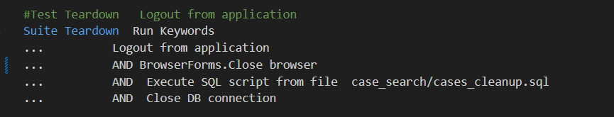

As far as I can follow your description it´s not an xray problem itself but a problem in the testcase design within the robot test suit. As the error message points out a test case needs a dedicated "end" like a teardown in order to switch to the next test case.

You could annotate the RF test with the 3 test issue keys but I don't think that works, because it's not really a common scenario and Xray won't process all those tags (I think).
Using Automation from Jira, it's not possible to implement rules like that as there are no means to interact with Xray data in that detail, at least at this moment.

Hi @Marieta Uzunova , welcome to the Atlassian Community and thanks for your question.
Even though the Xray issue types exist as issue types in Jira, I fear that the data from the Xray app itself isn't accessible to the Jira automation. I have had similar issues with other apps, like Tempo, where you want to automate something in the app data, but this is only possible if the app has automation in it.
