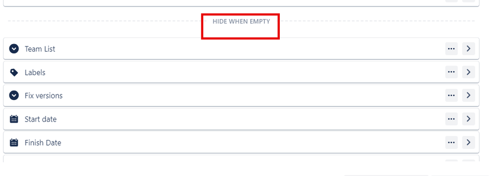

Shiva Kumar Hiremath
November 27, 2024
Hello @Shaun McGuire ,
You can configure the issue screen,make the fields hidden only when empty.
Marc -Devoteam-
November 27, 2024
Hi @Shiva Kumar Hiremath
As mentioned in the post by @Shaun McGuire
This is about the main content section of the issue, not the issue details section of an issue.
Please read the post with attention :)
