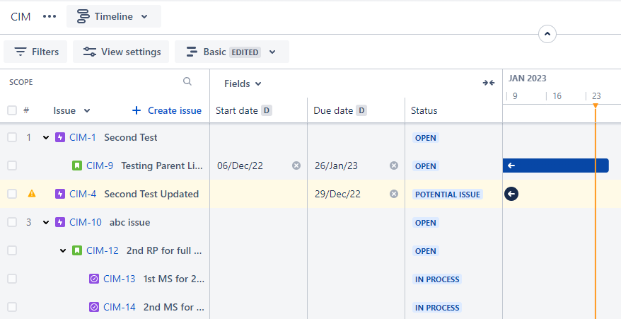

Can you share a screenshot that shows the relationship between the tickets? Also which relationship are you using on the post function. You may be using link relationship type (parent of) instead of the parent-child link that is used for advanced roadmaps for example.

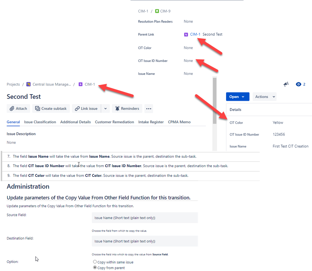

The top picture is the Child and is also the issue with the Post Function. You can see in the second picture that there are contents in the fields. The third and 4th pics show the Post functions for the fields I'm showing. Here I am showing the screens for the create transition but I use the same post functions further down the workflow as well.
Also, I have confirmed that I have published the workflow. Thanks for your quick response so far I'm looking forward to having this one solved!
Based on the pictures, you are using the Parent and Child link from Advanced Roadmaps. (I see a Story and Epic)
The post-function you have only works for parent and subtasks relationships. I think that's why it doesn't work.
I suggest you use Jira Automation instead where based on a trigger you can copy to the children.

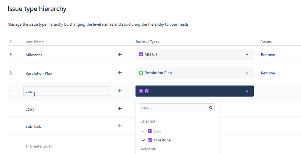

Based on what you are saying I'm going to try something to see if it will work but neither of the issue types I'm using now, are actually an epic. I just use the same Icon for epic on MH CIT issue type.
I will say, once I get this working I will want to use the Resolution Plan issue type as the parent for Milestone issue type. You can see my hierarchy screen below. To me this hierarchy is counter intuitive but in having it set up in this way allows the Plans to work properly, bottom screen.

Thanks for sharing. Either way they are not subtasks of a parent so that's why the post function doesn't work.
Use this video as an example, it will be the second rule and instead of subtasks you are looking into a parent-child relationship. Link: https://youtu.be/DcPYrw-Puus
