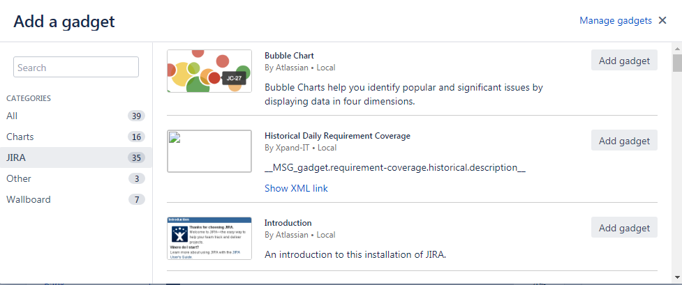

Most of the internal gadgets title are appearing as __MSG_gadget.xxxxxxxx.
I could see below errors in the logs (JIRA 7.10.1)
WARN [o.a.h.impl.auth.HttpAuthenticator] NEGOTIATE authentication error: Invalid name provided (Mechanism level: KrbException: Cannot locate default realm)
WARN akshatha 824x269x1 /plugins/servlet/applications/versions-licenses [c.a.u.application.marketplace.ApplicationMarketplaceQueriesImpl] Marketplace product query failed: com.atlassian.marketplace.client.MpacException: javax.net.ssl.SSLHandshakeException: sun.security.validator.ValidatorException: PKIX path building failed: sun.security.provider.certpath.SunCertPathBuilderException: unable to find valid certification path to requested target
Would be helpful if I get suggestions on how to debug.
