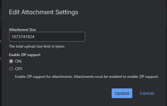

Check what you have set as the maximum file size for attachments.
mbaig
June 24, 2025
File size was indeed our first guess, 1GB is our maximum file size and the files that fail are well below that.  We've had users report failure with videos as small as 60MB.  And as I mentioned earlier we are able to "work around" this by manually attaching the file through the web interface.
