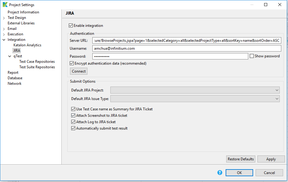

Hi all.
To integrate Katalon Studio with Jira, it requires server URL to connect. How do I get this url?
I tried with https://infinitium.atlassian.net/, this is where I arrive at the login page.
I also tried URL which directs to projects, but still not working.
Thanks in advance.

It looks like you have Jira Cloud (infinitium.atlassian.net), but Katalon only supports Jira Server - https://docs.katalon.com/katalon-studio/docs/install-and-use-katalons-jira-add-on.html
The add-on is listed at Atlassian Marketplace. Currently, we only suport JIRA server. To install the add-on, please follow Atlassian’s instruction.
Have a chat to the Katalon community and see if anyone is working on a Jira Cloud integration.

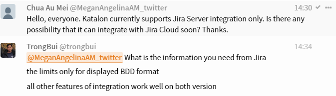

Hi @Jimmy Van (GLiNTECH)
Thanks for  your reply. I had consulted Katalon Community Chat, he said that Jira Cloud can be integrated.
So, where can I get my Server URL ya? Thanks in advance. Appreciate your help.

You will need to ask Katalon what they expect you to put in.
The short answer to "what server url do I need" is "https://infinitium.atlassian.net/", but it sounds like Katalon needs something else.  You will need them to explain what that is, we can't guess.
