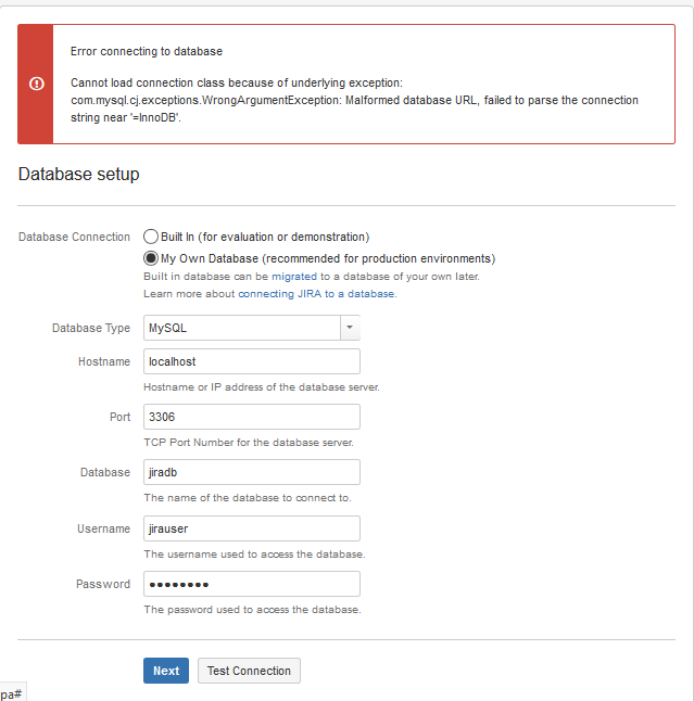

Frank Høvin
April 23, 2018
While troubleshooting this, I removed the dbconfix.xml file, stopped the server - and was forced to kill the Tomcat process manually - and started it again.
I was now taken to the initial Jira installation page, where I could select to set it up myself, and use my own database.
Naturally, this solved nothing. Jira is still unable to connect to the same database as Conflucence is currently connected to!!!
And the log basically says the same thing:
2018-04-23 12:54:43,851 http-nio-8080-exec-1 ERROR anonymous 774x284x1 1klynuu 95.128.111.111 /secure/SetupDatabase!connectionCheck.jspa [c.a.config.bootstrap.DefaultAtlassianBootstrapManager] Could not successfully test your database:
java.sql.SQLNonTransientConnectionException: Cannot load connection class because of underlying exception: com.mysql.cj.exceptions.WrongArgumentException: Malformed database URL, failed to parse the connection string near '=InnoDB'.

Caused by: com.mysql.cj.exceptions.UnableToConnectException: Cannot load connection class because of underlying exception: com.mysql.cj.exceptions.WrongArgumentException: Malformed database URL, failed to parse the connection string near '=InnoDB'.
        at sun.reflect.NativeConstructorAccessorImpl.newInstance0(Native Method)
        at sun.reflect.NativeConstructorAccessorImpl.newInstance(NativeConstructorAccessorImpl.java:62)
        at sun.reflect.DelegatingConstructorAccessorImpl.newInstance(DelegatingConstructorAccessorImpl.java:45)
        at java.lang.reflect.Constructor.newInstance(Constructor.java:423)
        at com.mysql.cj.exceptions.ExceptionFactory.createException(ExceptionFactory.java:59)
        ... 155 more
Caused by: com.mysql.cj.exceptions.WrongArgumentException: Malformed database URL, failed to parse the connection string near '=InnoDB'.
