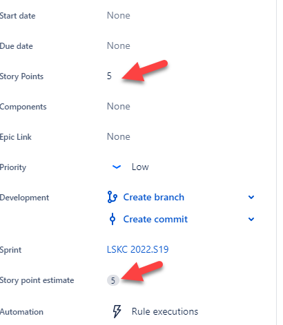

@Trudy P Claspill Thank you so much for your response! I really appreciate it. For some reason, we have 2 "Story Points" fields that have the same exact name of "Story Points" in the configuration but show up as 2 different fields below. If we use the "Story Points Estimate" field, Insights does not work but it populates on the card/ticket. If we use the "Story Point" field, the points do not populate on the cards/tickets and Insights sort of work :(.
There are several things to unpack there.
Can you show us the configuration screen you are referencing that shows two Story Points fields?
Jira has an out of the box custom field named Story Points that is typically used for story points in Company Managed projects. It is bad practice to create another Custom Field with the same name as an existing one, though Jira does not prevent it.
In Team Managed Scrum projects you'll find a built-in custom field named Story Point Estimate. You won't see that field in the Custom Fields list where fields are created for Company Managed projects.
The two types of projects use two different "built-in" fields for Story Points.

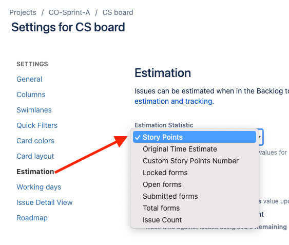

What is the Estimation Statistic for the board?
What do you mean by "does not populate" on the cards/tickets? Can you show a screen image of that?
@Trudy P Claspill We aren't using any Estimation fields and I think that is why Insights isn't populating. I'm going to try populating that field when we start our next Sprint and see if that works. I'll report back if it doesn't. Thanks for your feedback!
The Insights will need to have the Estimation Statistic option set in your board configuration.
And that is the field within the issues you will need to populate in order for Insights to show you data.
Below is an example from a board for a Company Managed project.
