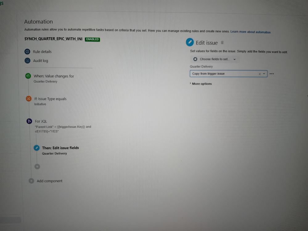

I need help again. I need to build automation When Initiative Changed update also child EPIC.
I am using "Parent Link" = {{triggerIssue.Key}} method and it works perfectly fine:
but ONLY in case when I have:
1. One Inititaitve
2. One EPIC
My Scenario is:
1. One Initiative
2. Many EPICS
3. I want to update only one EPIC with customField = YES
The problem is when I add condition ISSE FIELDS CONDITION
Field: customField
Value: YES
between Branch and Action automation rule doesnt recognise this condition. As result when I change Initaitive value still BOTH EPICS are updated instead of One (that One with CustomField=YES)
And i am wondering if such field condition should be set on BRANCH JQL level i.e.
"Parent Link" = {{triggerIssue.Key}} and customField=YES
But this solution doesnt work

Can you please post a screen shot of the rule that you have so far? Also please show details for the branch you are using.
Very good - thanks for that.
I don't use Data Center very often. Is there an option for the Branch for Children?
If so, you might use that instead of the JQL. Then add a Condition under the Branch for checking if the field = Yes.

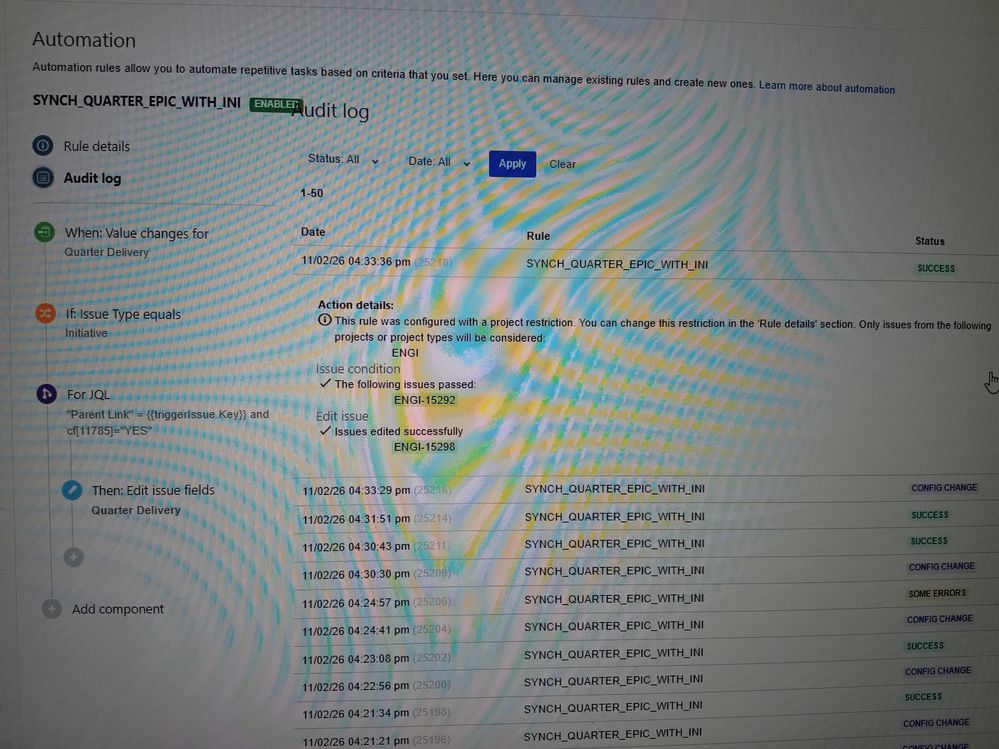

@joh @Bill Sheboy ....my automation with condition works...
It was not about condition itself, there was ANOTHER GLOBAL automation which impacts my second EPIC. Thank you for quick reaction anyway
sorry but I had to took a photo (screenshoot upload limitation)
ENGI-15292 - INITAITIVE
ENGI-15298 - EPIC 1 (with customfield YES)
ENGI-15299 - EPIC 2 (withOUT customfield YES)
I logs there is full success but log info informs only about EPIC 1
but EPIC 2 is also updated
