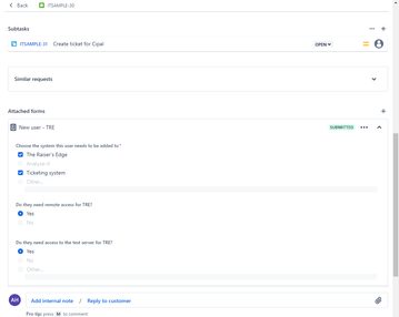

As an admin I created a request with different custom fields like 'which system they are using', what their username is etc. Aside from these fields, I also added a form as I need some conditions for some of the questions.
When the ticket gets created, and I go to the admin side, I only see the information from the form directly in the ticket.
The information that the end-user added as an answer to the custom fields is not shown.
How do I get this to show up in the admin side of the ticket as well?
Or should I just use the link 'view request in portal' which seems a bit silly to use.

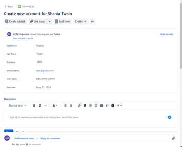

Like I said above, I have created custom fields. I have these custom fields to the request as well and I have used these in a form. The problem is that it doesn't show the information to these fields when the end-user filled in these questions for their request.

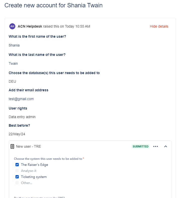

Here you can see the filled in question from the ticket on the end-user side.

So just to be clear, what you are missing on the "admin side" are fields with the answers "The Raiser's Edge", "Ticketing system" ... etc?
I do understand that you have a mixed Request form containing Custom Fields and a Form created in the Form designer.
What is normal behaviour is that you will see the fields on the Request form (added as Custom Fields) as fields on the resulting ticket. That I can see from your screenshot is ok.
The other questions (in the Form) are in the Form section (bottom half of your screenshot). The way I understand your question now is how do you get the answers to those questions also visible as fields on the resulting issue?
