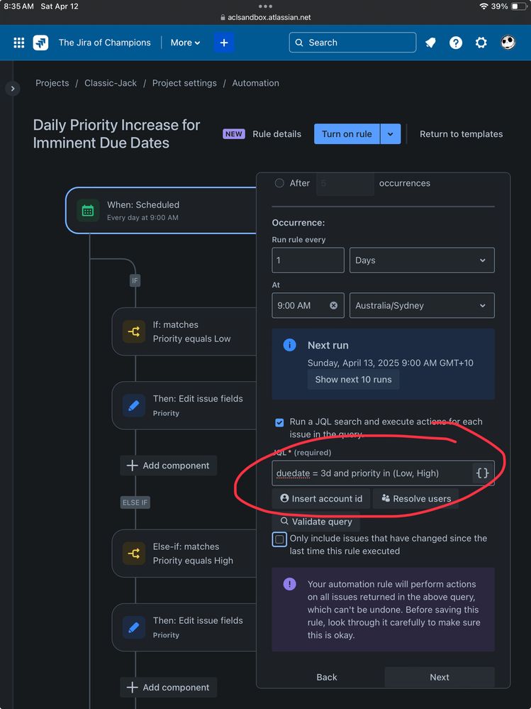

Hi @Sébastien OZANNE , you can use automation for this. You would set up a a scheduled rule that would run daily. In that schedule component use JQL to return all issues that are due within three days. Then use if/else to raise the priority.
here is a quick example.

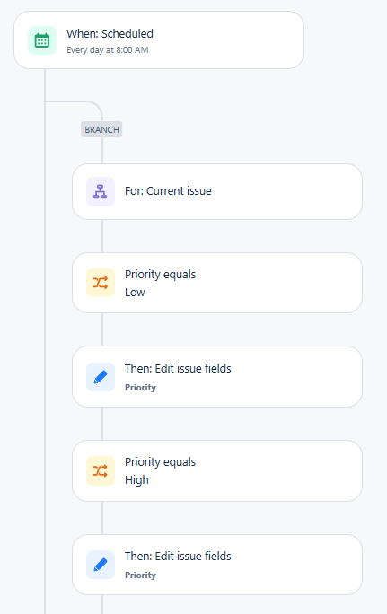

I did not succeed to implement my automation like you.
I do not have IF branch
Sébastien OZANNE
April 15, 2025

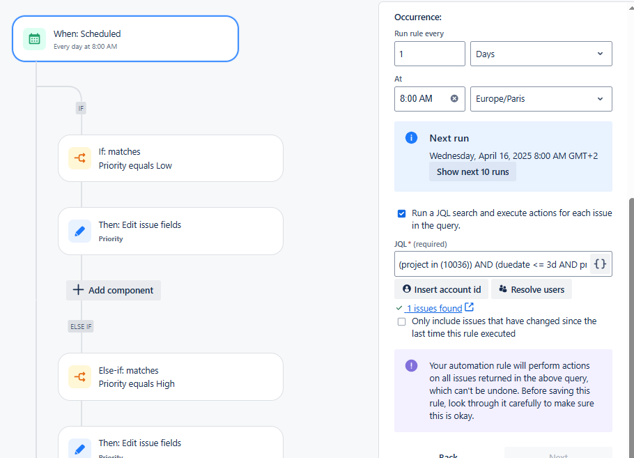

It is OK, I succeed to do what you did. My bad.
I use thise JQL query :
duedate <= 3d AND priority IN (Low, High) AND statusCategory != Done
❌ 1 issue found, I run the automation manually but nothing happens.
Sébastien OZANNE
April 25, 2025
✅ Ok, it works
But I don't know why but when I try to run the automation manually, it doesn't work.
