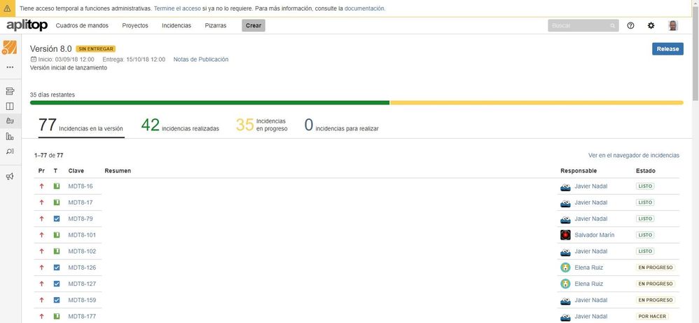

I have reindexed but it occurs the same. Let me explain better. You can see in the following image in Spanish that there are 0 issues to do (incidencias para realizar) but the issue MDT8-177 is POR HACER (to do), so I think that the number of issues should be greater than 0.Captura.JPG

Thanks for the screenshot.
From this we see that the POR HACER (to do) status seem to be in the category of In Progress. This we understand from the color Yellow. To change this:
  1. go to the status page, which can be found in {{Jira-Admin-menu>>Issues>>ISSUE ATTRIBUTES>>Statuses}}.
  2. Here look for POR HACER (to do) status
  3. You will notice the Category column.
  4. Change the Category column from In Progress to To Do.
  5. Then check back on the releases page.

Excellent! Now the summary info is correct.
Thank you very much for your precise answer.
