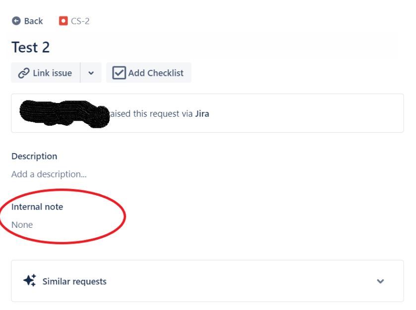

I work with Jira Service Desk where I create a linked issue to another business project (Product Development Team). When I create the linked issue, the Description is included by default.
However, I also want to include 'Internal Note' which is the second text field we have in our Service Desk.
How do I do this? I do not find any settings to include this second text field when I created a linked issue.

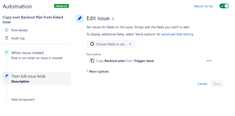

sure I can share my rule. In this example "Backout Plan" = what you are referring to as "Internal Note".
It is a very simple rule but in my tests it worked well. I am wondering if it would do the same for your requirements - considering that there are more fields to be carried over in your example.
For the trigger (here: Issue Created) I seem to have understood you prefer to choose "Issue Linked".
Regards,
Daniel

If you see the picture,  I use 'Link Issue' from our Service Desk ticket here to create the business project issue (in our company for our Programmers).
However, when the new issue is created, Only the 'Description' part is included and the 'Internal note'  part is not.(I have to type it again manually so our programmers can see the complete information).
Is there a way to include both of these fields, Description AND Internal Note?
Thanks in Advance.
