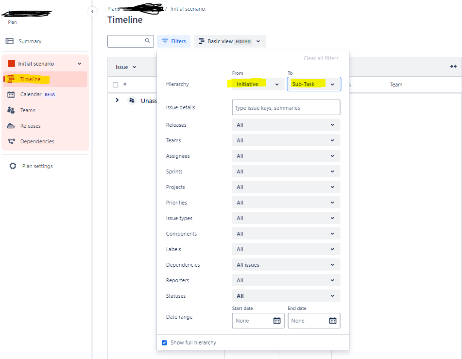

 You have to use Advanced Roadmaps "Plan".
* Create a filter that will cover all required projects.
* Create a plan then use the filter you created.
* In Plan Timeline, you can filter it From Initiative to subtask

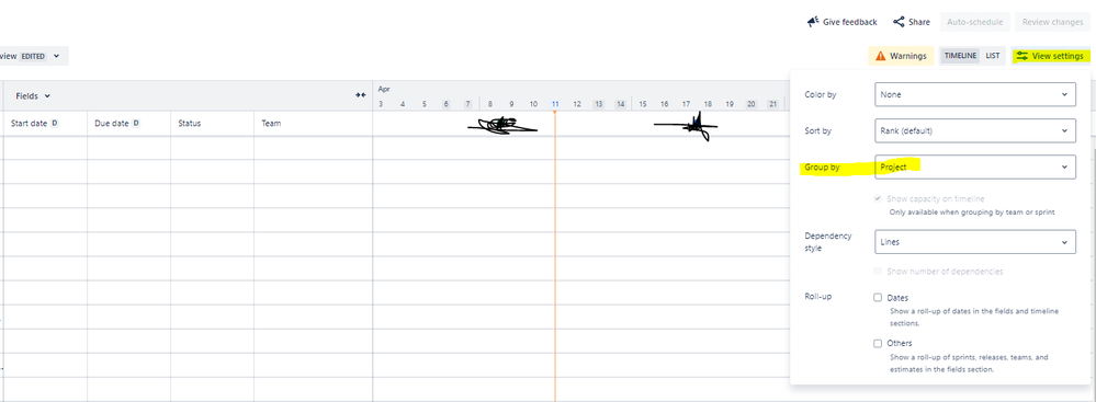

Also you can group the issues by project - View settings - Group by - Project
