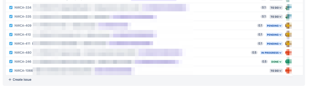

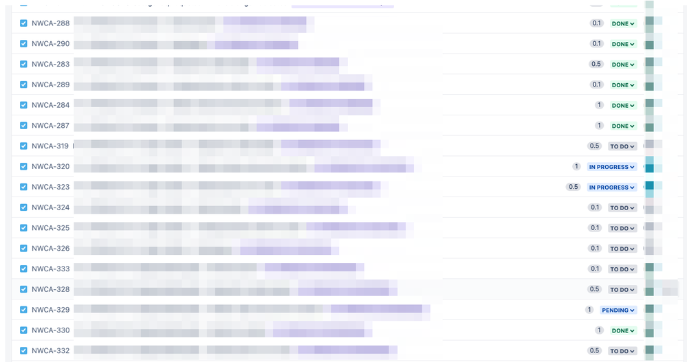

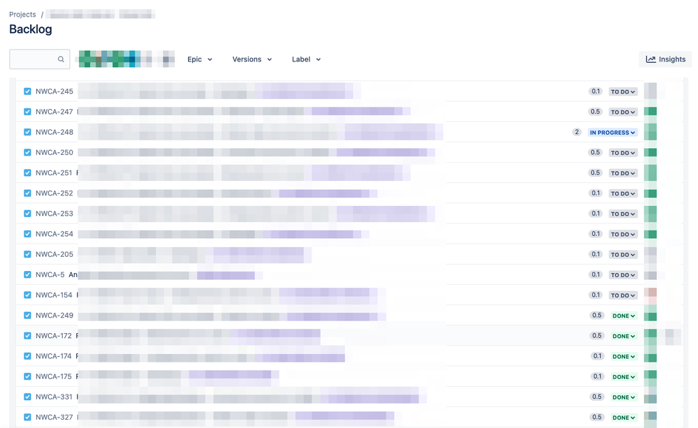

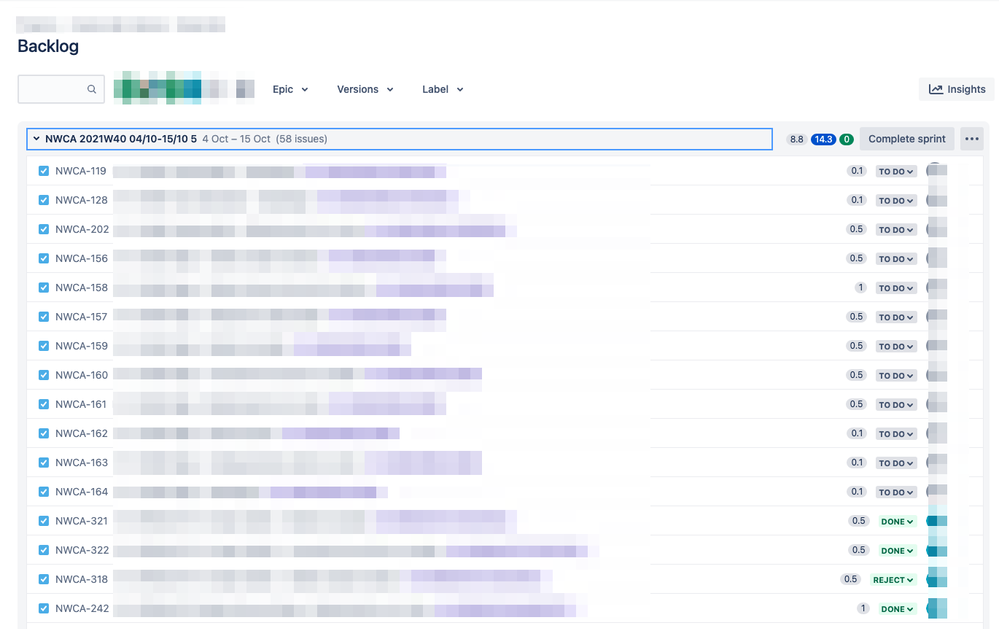

Ok, so we'll need to see the list of issues in the sprint, only showing us the key (just so we can see it's one issue per line), the status and whatever you have selected for the estimation field, plus a shot of the header of the sprint where the numbers appear to be adding up wrong.
mgabarro
October 6, 2021
Nic Brough -Adaptavist-
October 9, 2021
The other numbers don't add up either.  That makes me think you've selected a different estimation statistic for the board, it's not the one you're displaying.

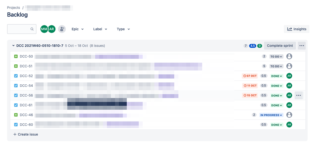

I have looked for another backlog where the data can be seen more clearlyCaptura Backlog.png
October 18, 2021
That's the same.  It really does look like the estimation statistic you've chosen for the board is not what you've got in the issues.

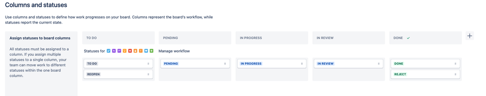

mgabarro
October 18, 2021
That is the error. There are 8 tasks:
- Not Started: 7 Story Points
- In progress: 4.5 Story Points (the correct value would be 2)
- Done: 0 Story Points (the correct value would be 2.5)
It is counting the story points "Done" as "In progress"

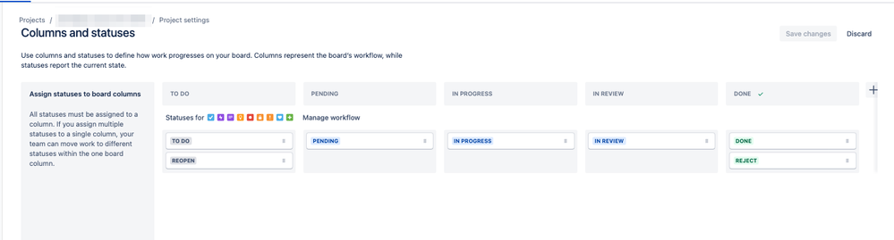

October 18, 2021
Ah, I see, sorry, I mis-added up the numbers and didn't spot the "done" issues are being added to the in-progress count.
As the numbers are being added to the in-progress column, that suggests the five issues are not sub-tasks, which is one reason they wouldn't add up.
It only really leaves us with the possibility that the issues are not in the last column in the board, so they're not "done", despite what the status is called.
