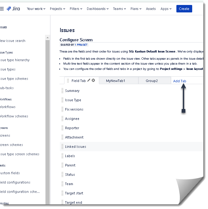

In an issue, is there a way to add columns and then fields within those columns?
Sunil Aggarwal
January 15, 2025
I need to add a lot of fields and having them in one column on the right-hand side of the issue is just not practical. So I want to add multiple columns so I can add more fields in. Has anybody done this before or know how?
Also is there a way to add a title to the group of fields?

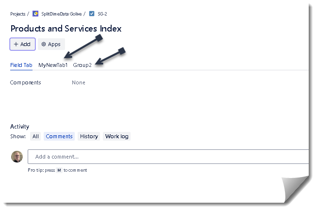

I'm not totally following the specifics and previous answer, but you can add tabs to a screen and use that to group related fields.  I added these two tabs as an illustration

@David Nickell I've run a quick test on the tabs solution and that is amazing!
