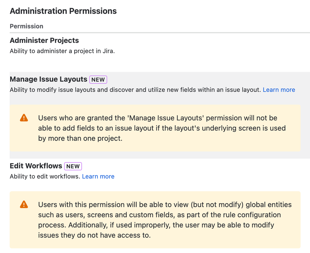

Thanks for the clarification. So Administer Projects gives you Manage Issue Layouts and Edit Workflows automatically (as before), right?
Vignesh Jayagopal
March 6, 2025
@Dave Mathijs Yes, users with Administer Project permission can edit the issue layout. However, I don't believe they were previously able to edit workflows, as only users with Jira Administrator permission have the ability to modify workflows.

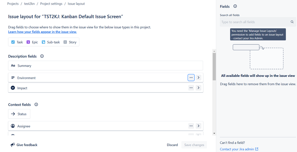

Could you please confirm whether the permissions have been separated? Although I have the Administer Projects permission, I'm unable to edit the layout in the UI because I lack the Manage Issue Layouts permission.
with Administer Projects permission and manage layout permission
testing1
March 6, 2025
Vignesh Jayagopal
March 6, 2025
Hi @testing1
You are trying to add a new field to the screen, for that you need the "Manage Issue Layouts" permission.
With the "Administer Projects" permission, you can still edit the layout by rearranging existing fields, changing their order, or moving fields between the Description section and Context field section.
Additionally, even if you have the "Manage Issue Layouts" permission, if the screen is shared across multiple projects, you will need Jira Administrator permissions to add new fields to the screen.
