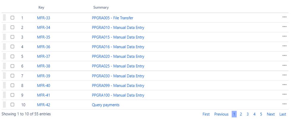

I have a set of 56 tests that have been added to a test set. I have created a Test Plan and added the Test set to it. However, the order of the tests in the Test Set is not reflected in either the Plan, and consequently, in the resulting Test Execution created from the Plan. Why is this happening and is there anything I can do about it?

Each Test was originally created from within the Test Set. They were created in order and, fortunately, they are in key order, so, I do have a work around in the Plan, fortunately. What I don't understand is why the order in the set is lost when adding the Set to the Plan. I took a couple of screenshots. The Test set order is first...showing page 1 of 5 and in the correct order. The created Test Plan is second, also 5 pages but in the order they were automatically loaded into the Plan from the Set.
Whats also strange, I believe, is that its not possible to re-order the tests in the Test Set. I believe that it is supposed to work the same as in the Plan and Execution, but it doesn't. Could this indicate that there is something wrong with the Test Set in our installation?
