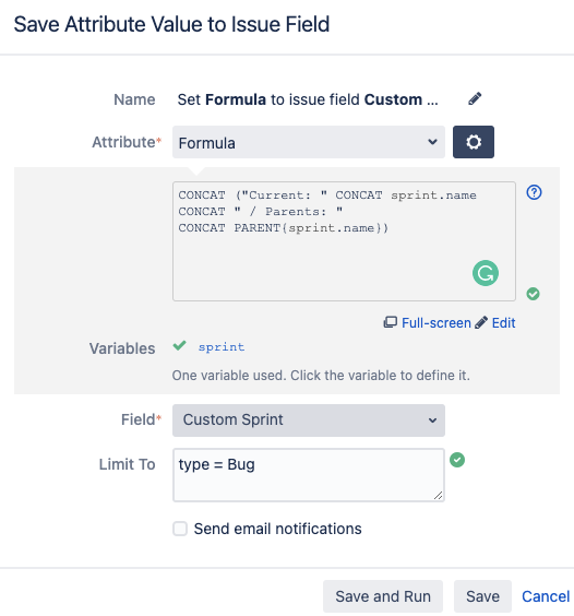

then, you will need to create a new Text Custom Field and change the Effector configuration to write the value to this new field.
The steps will be the same, just need to update the Field with the new custom field name, and the formula code will be something like this:
CONCAT ("Current: " CONCAT sprint.name
CONCAT " / Parents: "
CONCAT PARENT{sprint.name})
It should look like the below:

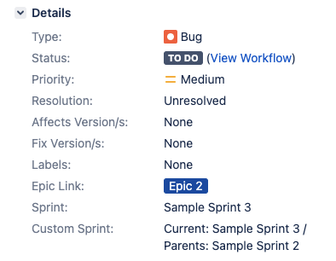

Here is the result of the above example in the Bug View Screen (Custom field name: Custom Sprint):
