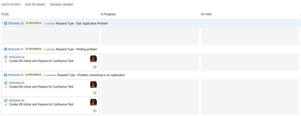

In Progress issues on sprint board showing under To Do column when subtask is added
Beth Starr
February 14, 2018
When a subtask is added to an issue in Jira, the Sprint board shows the In Progress issue under the To Do column.  I thought maybe this was a browser issue but when Shrink my screen to 50% it still displays under the To Do column. I tried different browsers and it is displaying the same way. The subtasks have been closed and the parent issues are in the status of In Progress so it can't be related to the status of the subtask. You can clearly see the issues are in the status of In Progress so how can I fix this?  Sprint Board displaying issues in wrong column.JPG
Nic Brough -Adaptavist-
February 14, 2018
The sub-tasks are created in a "to do" status, so they go into the "to do" column.  Note that the parent issue does not have any separator columns, it's just there as a container for the sub-tasks.
Beth Starr
February 14, 2018
Nic,
Thanks for the response.  As I stated above the sub-tasks are in "Closed" status, and the parent issues are in an "In Progress" status, so this does not explain why the "In Progress" issue is in the "To Do" column. Everything was fine until the sub-tasks were added to the issues and this is when the sprint board changed. Sub-tasks should be able to be added to issues without it making the sprint board a mess.  I could understand if the sub-tasks were in an "open" status that this issue (parent) could display in the "To Do" Column even if it was in an "In Progress" status, but this is not the case.  If the sub-task is "closed" and the parent issue is "in progress" then the issue should not display in the "to do" column.

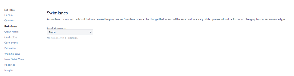

Deleted user
December 7, 2022
I had the same issue, to resolve this use the Swimpalne option under board settings and set it to None
Jack Brickey
February 14, 2018
@Beth Starr let's do two things:
  1. open Board settings and look at the Columns screen. What statuses are mapped to which columns? Screenshot?
  2. open each issue and verify that the statuses are indeed as you indicate (closed, in progress, to do).
Beth Starr
February 14, 2018
I opened the board settings and looked at the column mapping and it is as follows:
To Do ->Backlog
In Progress ->In Progress
On Hold -> On Hold
Review ->Pending Review
Done -> Closed
I opened the issues and the Parent issue is in the status of In Progress and the Sub-task is in the status of Closed.  Everything was correct on the board until sub-tasks were created and the view changed.  The board configuration did not change.
