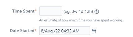

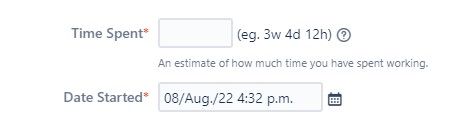

Paul Monk
August 8, 2022
Popup when it first opens:
After picking the date from the calendar:

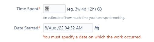

But it's not how the date displays that's the problem. It's that it causes a validation error. Even if you change it to look like the first screen shot, it still does not validate.
Florian Bonniec
August 8, 2022
Not sure how to solve this issue but I think the expected format in order to be a valid date is 8/Aug./22 04:32 a.m.
