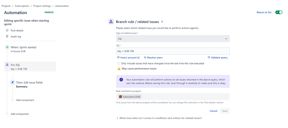

@Cash Coyne
You need to make a rule as follows:
Trigger: Sprint Started > Insert the board where the sprint has been started
BRANCH > JQL
At the JQL branch use: key = your_issue_to_be_affected
Inside the branch add and Edit Issue action and insert the field to be edit. So when a sprint is started on the board that you defined in the trigger, this issue that you put in the branch will have the field edited. See the image about the automation rule:
Hope this helps :)

Cash Coyne
January 10, 2023
That worked!  Thanks!

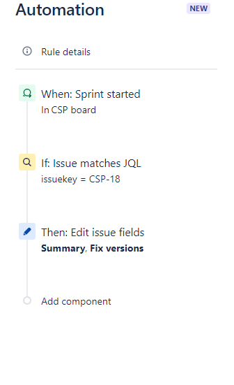

Vamsi Kandala
January 9, 2023
Hi @Cash Coyne
Please try following these steps and check:
  • Select the 'Sprint started' trigger
    • It will ask for the 'Boards', choose one accordingly
  • Add 'New condition' as the component
    • Select 'JQL condition
      • Provide the JQL query mentioning the issue key
  • Select 'New action' as the component
    • Select 'Edit issue'
    • Select the appropriate field(s) to edit
Attached the screenshot here:
Hope this helps.
Thanks,
Vamsi
Cash Coyne
January 10, 2023
Hi @Vamsi Kandala , when I try that, I get this error:
  • The rule has been configured with components that require issues to be provided by the trigger. To run these components you must add a branch for this sprint or JQL. The following components require issues: JQL condition, Edit issue
And that's using this condition:
key = JPRJ-103
