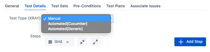

The test types I could see in XRay are Generic, Manual and Cucumber. How to create a test which you have mentioned as Automated[Generic]?
srinathbhaskaran
December 9, 2021
These are the options I see. My understanding is, you need to have these options visible on the UI before you can create the tests via REST API.
@Amit Rawat
