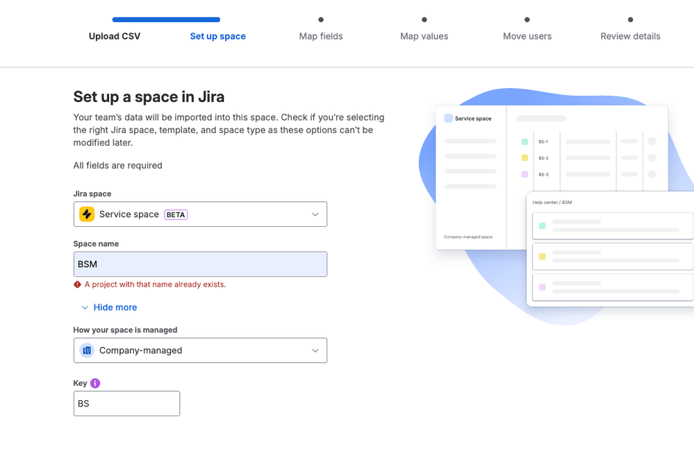

I tried using External system import with my .csv file that contains maximum allowed limit of 6k tickets - at the end of the process I selected a new project name and key and after some time, everything went well - I can find my 6k tickets into this newly created JSM project.
The problem I have is that when I try to import the rest (another 6k) tickets into the same JSM project - I get the warning that project already exist. It seems that with External system import tool it is not possible to add tickets from csv file into the existing project. Capture d’écran 2026-01-19 à 11.39.16.png

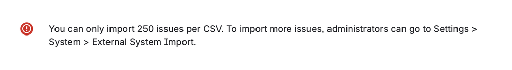

This documentation indeed does not mention any limit in the number of work items that can be imported into a existing project - but in reality there is a 250 items limit.

Hi @Marc -Devoteam- ,
That unfortunately does not change anything. In System Settings - External System Import the interface still asks me to select a destination project in a select box, with an error message saying "A project with that name already exists".

Using old importer experience worked!
With old interface, I can select existing project and import my csv issues without getting a "A project with that name already exists" error.
So this is a bug in a new import experience that was released.
