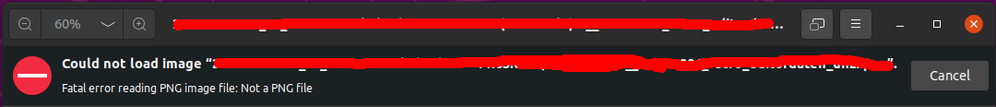

The attachments are correctly linked in the issues and also have the correct filesize, yet when we download the attachments and try to open it we get an error.
The links for the attachments are the same as other files.
Broken attachment: https://jira.company.de/secure/attachment/227874/2019-08-07%2010_56_53-DIZ%20PDB.png
Working attachment: https://jira.company.de/secure/attachment/229180/test.txt
I have already checked the file permissions and have reindexed Jira but the problem persisted.

Could it be the files got corrupted? If you remove and then upload the files to the server again and then perform the CSV import.
Does the issue occur for all issues in the affected project or does it happen only for some issues?
What is thrown in Jira log when you open the file.

I have tried your suggestion but to no avail.
I have downloaded the attachement directory for the specific project and imported this manually into the attachement directory on the target system.
After this I performed the csv import, yet i have the same errors.
I double checked all file permissions and owners, which all matched the other working attachments.
I have also checked the log during the import and i only get an warning regarding a parsing error for the date.
Cannot parse '23/Mar/18 7:15 AM;max.mustermann@sz.de;Ressorts.PNG;http:/jira.company.de/secure/attachment/34697/Ressorts.PNG' as attachment info: Unparseable date: "23/Mar/18 7:15 AM"
Cannot parse '23/Mar/18 7:14 AM;max.mustermann@sz.de;Ressorts.PNG;http://jira.company.de/secure/attachment/34696/Ressorts.PNG' as attachment info: Unparseable date: "23/Mar/18 7:14 AM"
If I open the broken attachements I can not see any logs being created.
So it is hard to provide some additional informations here.
The problem is affecting all attachements in all tickets.
