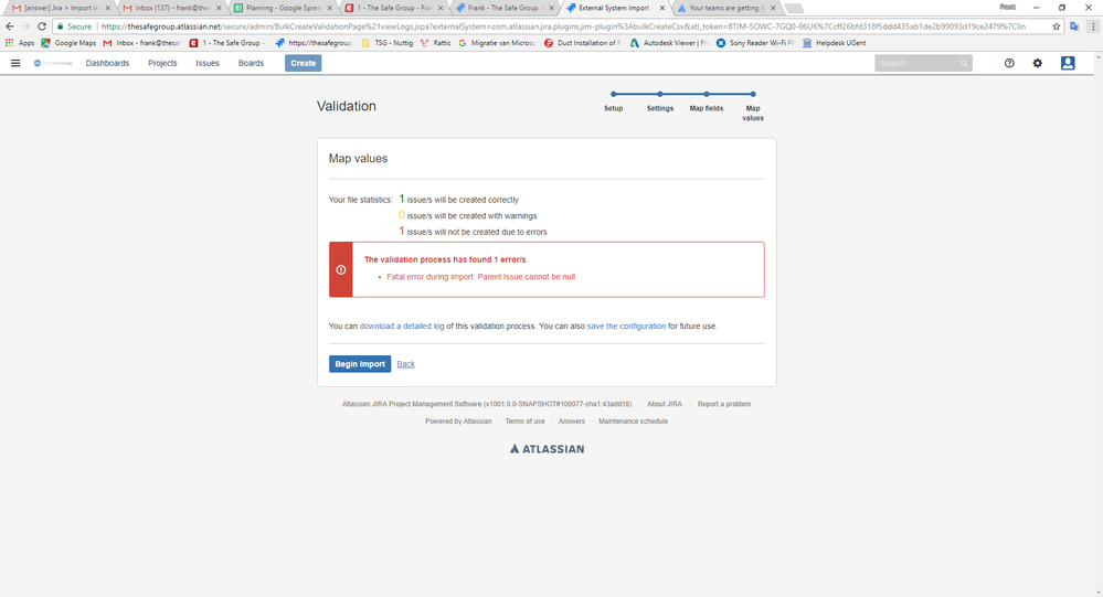

Frank Demuynck
January 26, 2018
I'm using the cloud verions.
I have admin rights
I can't vote in the issue JST-353921 (link doesn't go to the issue)
I'm use the import functionality sinds a year (it worked well until the end of december). So i think the CSV is ok
Underneath you find my CSV Content (example) and screenshot of the error (after validation)
project,Order,bestel,composedproduct,IssueType,IssueID,ParentID,Summary,blocks,Assignee,Reporter,Component,Description,Comment,OriginalEstimate,DueDate
WIBEMA,Nanobeam AC,1,,Task,1,,Controle bestelling - Ubiquiti NanoBeam 5AC 16db (2 Stuk - SNETWNBE-5AC-16),,wout,Frank,1231,,,18000,12-19-2017
WIBEMA,Nanobeam AC,,,Sub-task,101,1,Bestellen - Ubiquiti NanoBeam 5AC 16db (2 Stuk - SNETWNBE-5AC-16),,Pieter,Frank,1231,,,54000,12-05-2017
