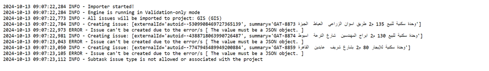

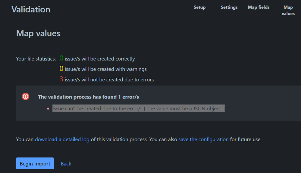

When import issue from CSV, the validation process has found 1 error/s:
  • Issue can't be created due to the error/s [ Not a valid JSON object ]
and the detailed log
my import file is CSV

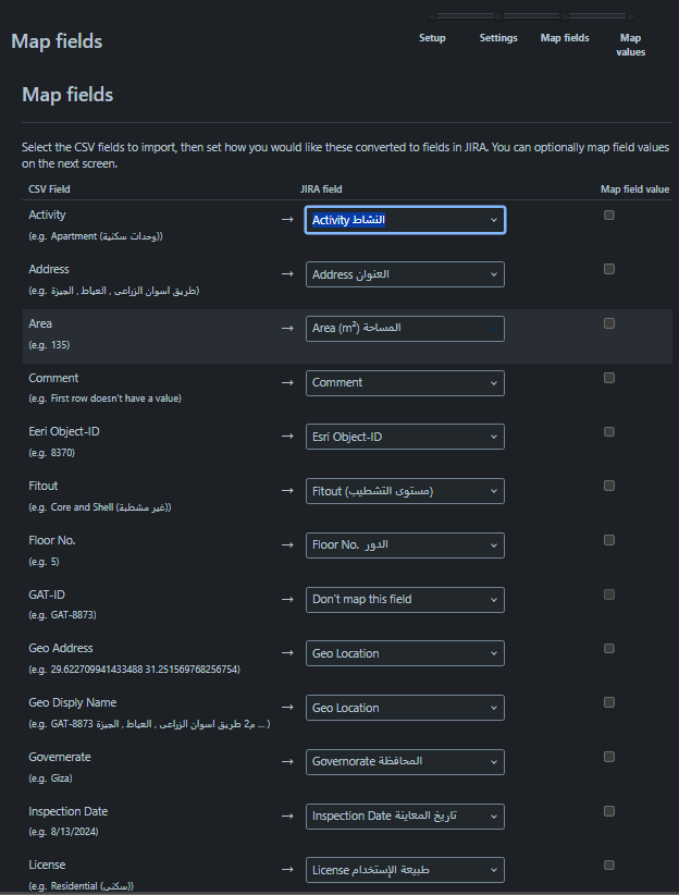

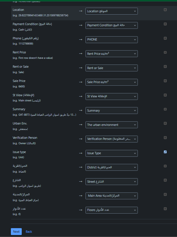

there is screenshots clarify the fields, values and map fields on jira in CSV (all these columns I use to import to the issue )

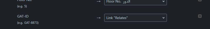

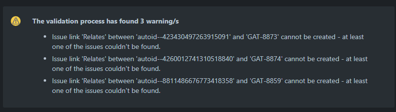

I use Jira keys to link the issue with issue in another project ( when i use link issues field there is error appear )
John Funk
October 13, 2024
I would take that out of the summary and try it. You only have 3 issues being created so you can link them manually after the fact.

This is a different problem. Are you trying to link the issues when you import them? I don't see you mapping that field above.
Also, what type of issue type is Unit - is it a sub-task issue type? Or a level 0 like task or story?

yes sure i am trying to link issues with map field , shown in screenshot below
Unit is an issue type in my project and i have another 2 issue types

But is the Unit a sub-task issue type (level -1) or at the same level as say Task (level 0)?
