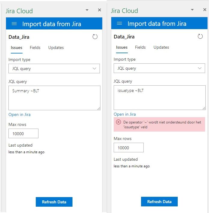

If you are talking about forming a JQL query from within Excel please provide the full JQL here and explain what your goal is and what is not working. Indeed the approximate symbol is not valid for the issue key. If you were just trying to find issues for a given project just use project = ABC.

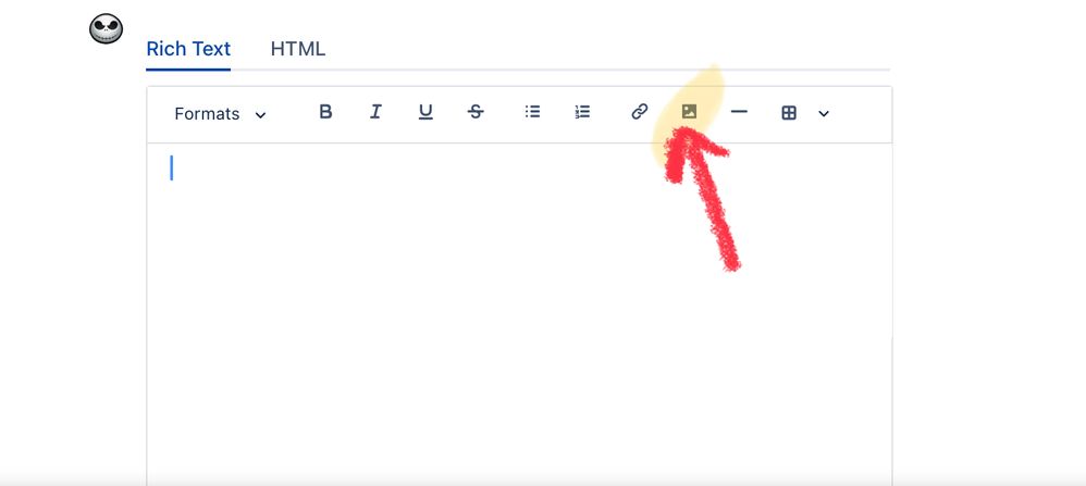

If you are trying to insert an image click the picture icon and upload/insert.
That is an invalid JQL. Is BLT the project key? If so use "project = BLT". If BLT is in fact an Issuetype then use type = BLT. The "~" operator is for text fields only. Based on what you have indicated I believe you want project = BLT.

I am using https://appsource.microsoft.com/en-us/product/office/WA200000556?tab=Overview
Attached 2 screenshots.
If I use "~" for field summary it works fine.
If I do the same for field Issuetype it results in an error
"The operator '~' is not supported by the 'issuetype' field"
