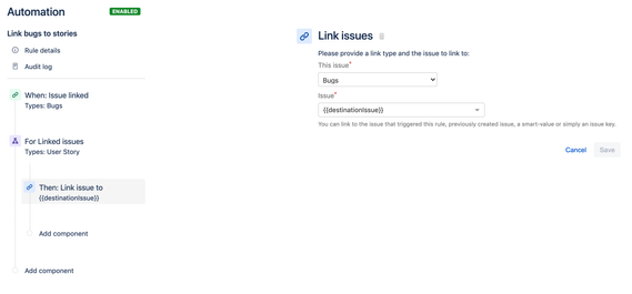

Hi @sonu verma
I created two issue links called "Bugs" and "User Story" to simulate your set up above.
I believe a rule like the following should do the trick:

Sonu Verma
November 11, 2020
Hii @Eric
Thanks for your help , your automation configuration worked for me ,
i was struggling on the link issues part but yours "{{destination Issue}}" gives
me my all answer
~Thanks

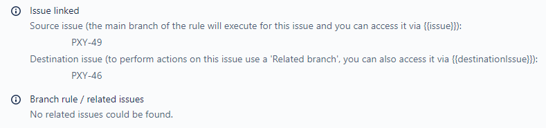

oliver.schulz
July 25, 2022
Hi @Eric , Hi @sonu verma ,
I'm struggling with the same case and can't figure it out even with the answer here.
I have the same requirement as sonu_verma, link the bug (PXY-49) to the story (PXY-17). PXY-46 is the test case.
PXY-17 is tested by PXY-46
PXY-46 is blocked by PXY-49
So:
But:
It's an old post, but maybe you're still around here :)
