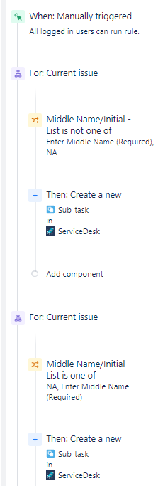

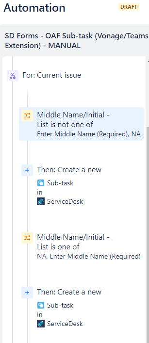

I have an automation (below) and I would like to use if/then statements to have a different action/sub-task created depending on the value of an issue field (Middle Name). I cannot get it to run at all if the 1st If statement (that it's not "Enter Middle Name" or "NA") fails. Normally, I would use an If/Then/Else block, but it seems that I'm using some kind of limited automation rule where the options for branching are limited, or am I missing something obvious?

Hi @MJCorcoran
You appear to be branching on current issue; that is not needed if your intent is only to work with the current issue (i.e., trigger issue in your case).
After you remove that branch, you may use the if/else conditions as they will not be under a branch.
Kind regards,
Bill
MJCorcoran
July 20, 2023
I actually double-branched and it work great. I tried using a variable, but it didn't work well.

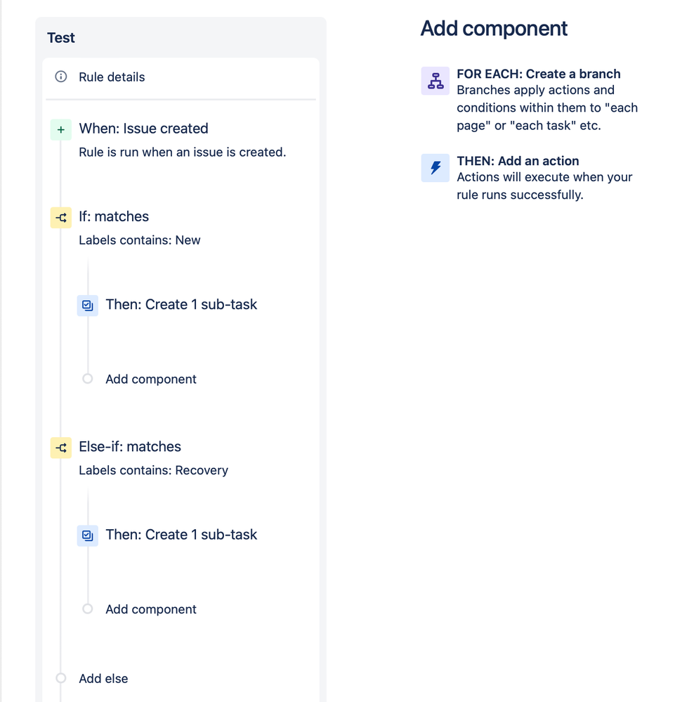

Hi, could you try automation shown on the image below.
