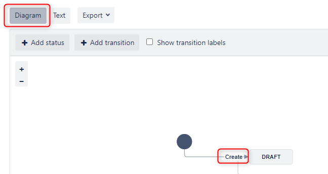

Hi @Raj Vora, it's pretty straightforward. My recollection is that there used to be more choices of validators on our Cloud Jira system, but at the moment it seems like the most restrictive validator is the "Permission validator", and the most restrictive option is "Project Administrator". So all you have to do is make sure that your project admins in the relevant projects know not to create any of these issues. If that's enough for you, here's how to do it:
  1. Find the relevant workflow on https://{your-instance}.atlassian.net/jira/settings/issues/workflows
  2. Edit the workflow
  3. If it comes up in the text mode editor, switch to Diagram mode
  4. Click on the "Create" arrow
  5. Click on Validators
  6. Click on Add validator
  7. Click on Permission Validator, click Add
  8. Select the Administer Projects permission, click Add
  9. Publish Draft
    1. This will bring up a panel which will prompt you to save a backup - that's generally a good idea!
  10. You're done!
