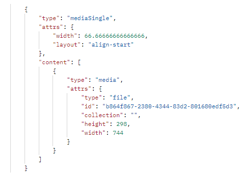

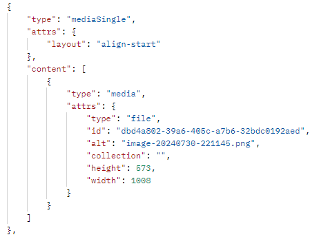

The Filename for an attached image it seems is inconsistently shown. It seems to be always shown in attachments section for an Issue but in the comments section it is shown inconsistently (I thought a solution could be to see which filenames were in attachments but not in comments which would mean the remainder would be description images). I’m not sure why the filename would be inconsistently shown. It’s not just between different Issues but within comments for the same Jira. An example below:
Comment section extract 1
Comment section extract 2
Height, Width is shown in Description and Comments sections for attached images. But then there is no way to marry this up with Attachments containing the download link because it does not show these and the Id is not the same.
Perhaps I am missing something from your answer you might be able to point out to me but otherwise I am not sure how to proceed at the moment with this approach.
