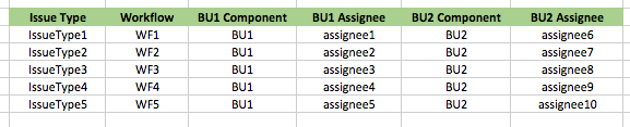

Today I have a project that I have setup with unique issue types and unique workflows per issue type. Part of the solution includes post functions in the Create transition to designate the assignee, again based upon Issue Type.
Now I am adding another business unit to the project that requires different assignees. Looking for ideas on how to accomplish.
so in the conceptual view below - If IssueType1 is opened for BU1 then Assignee = assignee1 if the Component = BU2 then Assignee = assignee6

@Jobin Kuruvilla [Adaptavist], thanks for the response. However, if I only have two BUs (Components) but 10 different assignees that would not work? Stating the issue another way:
IssueType1 + BU1 --> Assignee = Fred
IssueType1 + BU2 --> Assignee = Sally
IssueType2 + BU1 --> Assignee = Betty
IssueType2 + BU2 --> Assignee = Salaji
etc...
I'm currently looking at different options to my assignee dilemma to see if I can simplify it.
