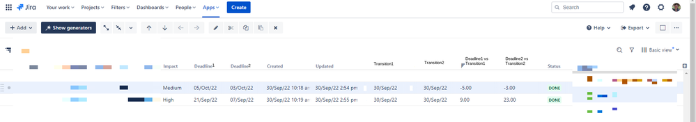

I had a similar use case for a customer that I implemented like this.
For each transition, we set a time goal, a custom field of the date type
Then I created another custom field of the date type, and an automation to populate it. The automation was triggered on the transition and captured the date the transition was executed.
Then, you need another custom field to store the difference between the two dates. I actually used the app Structure for this, to get a view like this -
So, in this case, I am showing the issues that transitioned before the deadline as negative numbers (as in, it was a negative number because it was early, or a positive number for the number of days after the deadline that the transition was completed). Of course the reverse or a different configuration would be possible.
If you are curious about other capabilities of Structure, you can check out their documentation here - https://help.tempo.io/structure/latest/formulas
I appreciate it's a little complicated, but with this type of configuration, you could monitor the performance of the different items of work versus when you had expected or wanted them to move through the workflow.
