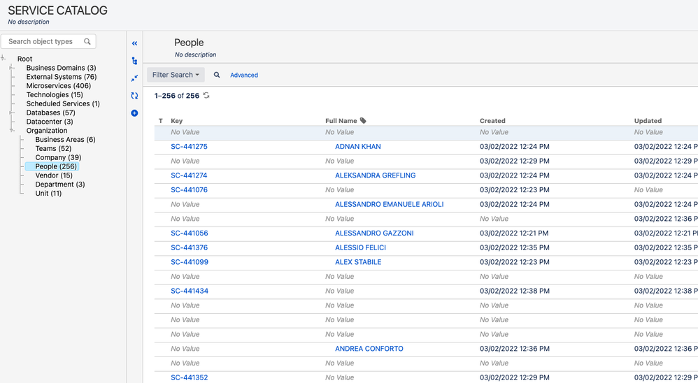

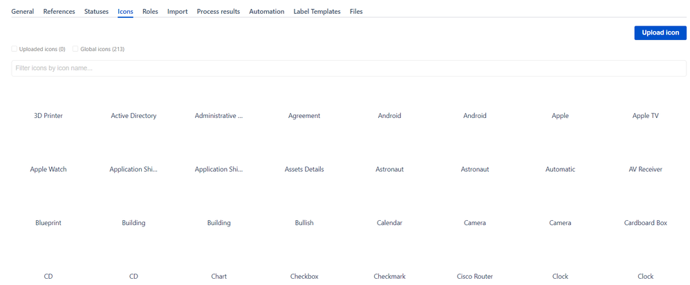

Today When I was trying to edit insight plugin configuration, I saw icons which we used for object schema are not loading and disappeared. Please find the screenshot for reference.
Can someone suggest what might be the issue.

First question : Are the other icons appearing on your instance (issue type icons, priority icons)?
We also noticed, some of the objects displayed with No Value, but we open, I can see the values in it.

Hi @Fabio Racobaldo [Catworkx] ,
Thanks for your help, Base url was changed by our network team, which got to know late. Now after updating it works fine.
