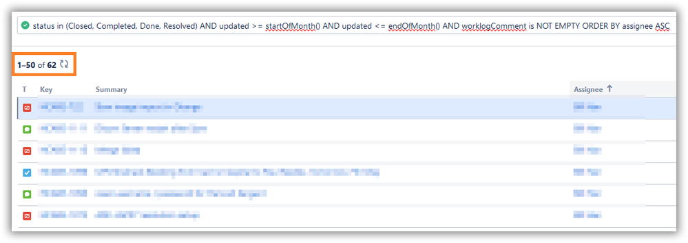

Hi All,

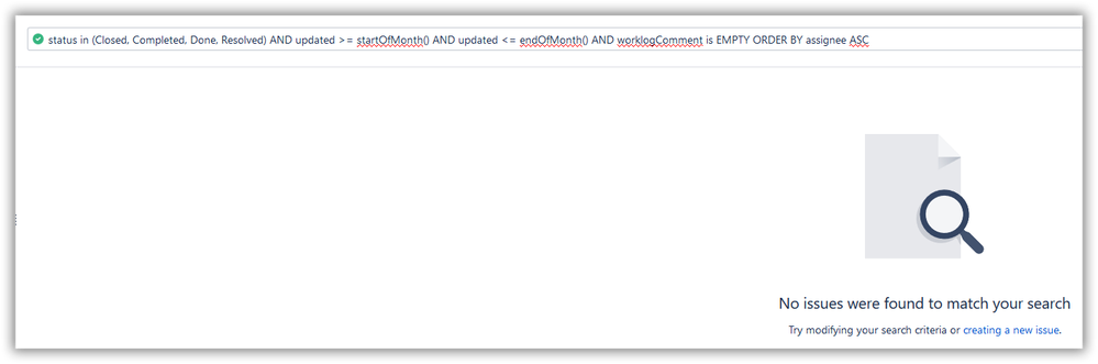

I am having difficulty with my JQL queries not behaving correctly, specifically with the 'IS EMPTY' operator.
I search for studies where I know there are empty values (in this case 'worklogComments'), but nothing returns.
I then perform a reverse search using the 'IS NOT EMPTY' and am returned results.
However, this result set does not contain all of the issues ( only returns 62 issues).

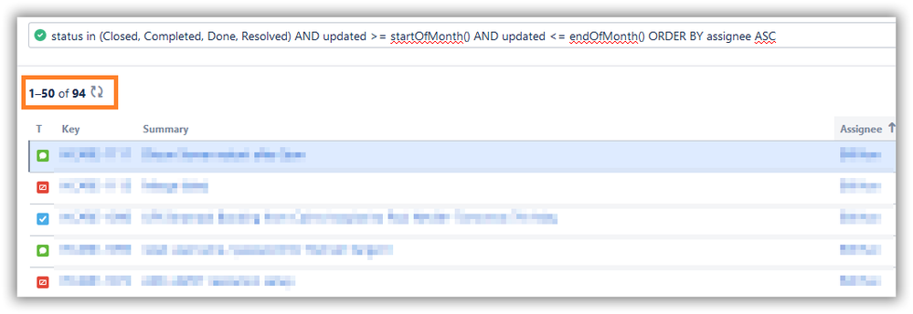

I verify this by running another query ignoring this field altogether and get 94 issues back for the same period.
So, from what I can tell, there seems to be an issue with the 'IS EMPTY' operator, but I have no idea what could be happening.

Hi @Mitchell Ekins
When I am running JQL queries about worklogs I keep all the terms about worklogs, for example, worklogComment is EMPTY AND worklogDate >= -32d AND worklogAuthor = currentUser().
The results you are getting may be due to the query trying to filter by issue fields and worklog fields.
