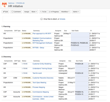

I have a custom field in my Epic type where I need to display information based on a variable within 'Component'. Is there a way this can be written for a JQL filter?
Example of this is:
If (Project = Optimus and Component = HR AND status != "3. Completed" ORDER BY status ASC), (Project = Optimus and Component = CXP AND status != "3. Completed" ORDER BY status ASC)
Is this possible?

Thank you. Sorry to confuse.
If Component = HR display issues where the status is not equal to completed and order by ASC
ELSE
Component = CXP display issues where the status is not equal to completed and order by ASC
I hope this helps to clarify what I want to do. The reason this has come up is I have installed the add-on Issue Matrix where it adds a visualisation based on a JQL Filter or Custom JQL mode

OK i see you point about ordering (obvious I am new to this)
If
Component = HR only display issues where the status is not equal to completed and order by status
ELSE IF
Component = CXP only display issues where the status is not equal to completed and order by "CXP type"
The intended result will be that when I open the EPIC with component = HR it will only display tasks created with the component = HR and then order it by the status field
where as if I open the EPIC with component = CXP it will only display tasks created with the component = CXP and then order it by the "CXP Type" field
The addon issue matrix displays configured columns (picture attached to demonstrate this). you can see by this at the moment that it displays all tasks with the status of Planning. Not just the ones for component HR. Yes there are more than just HR and CXP. I figured once I get the basics down I can add the extra as necessary
This is not going to work - you've built up an over-complicated requirement that can't be done without a lot of extra work.
