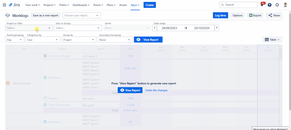

Tomasz Korusiewicz_SolDevelo
October 25, 2024
Hi @Andrea Parrell ,
If you don't mind using an application for such tasks, then I would like you to recommend the application developed by our team called "Worklogs - Time Tracking and Time Reports".
Worklogs allows you to precisely filter the company’s logged work with a wide range of filters such as users, issues, issue types, labels and more. Additionally, you can display the data for a specific date range with a breakdown by day, week, month or year.
Of course, you can track your Sprint progress, over the span of days, weeks etc. and compare it with the estimates:
It's also worth noting that the app uses Jira's native time tracing and time logs, meaning that any time tracked previously with this method before its installation will be present in Worklogs.
If you haven't tested our app yet, I invite you to do so - it looks like it should meet your requirements.

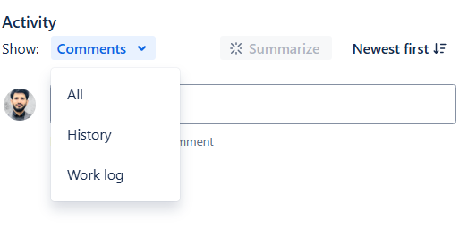

Asad
October 23, 2024
Hi! Here's the answer to your question:
Simply check at the bottom and select Work Log. The logged hours from the team member (assignee) will appear here. Thanks!
Check the screenshot, hope it helps!

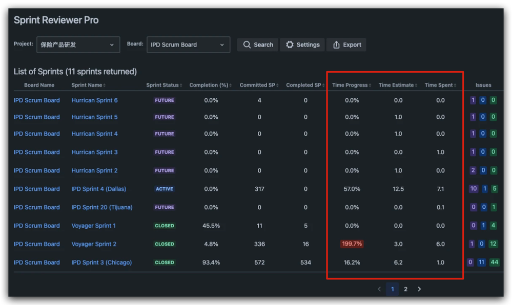

Yong Yang - 填空题咨询
October 23, 2024
Hi @Andrea Parrell
It seems your agile team is using time as estimation. You can configure the board Estimation with [Time tracking] and then use [Burndown Chart report] to see the time burndown.
If you want to see multiple sprint reports in a glance, I recommend you to try Sprint Reviewer Pro App.
